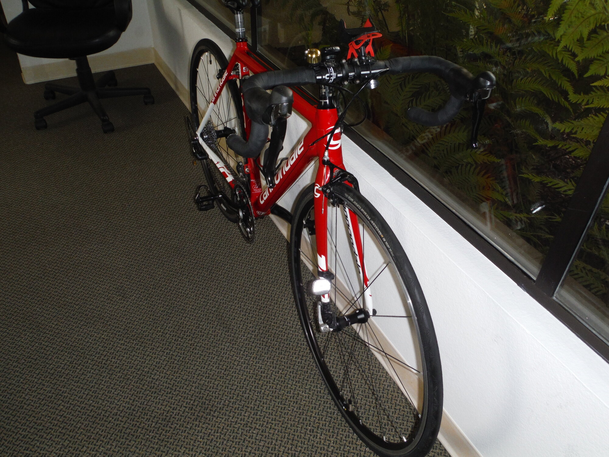

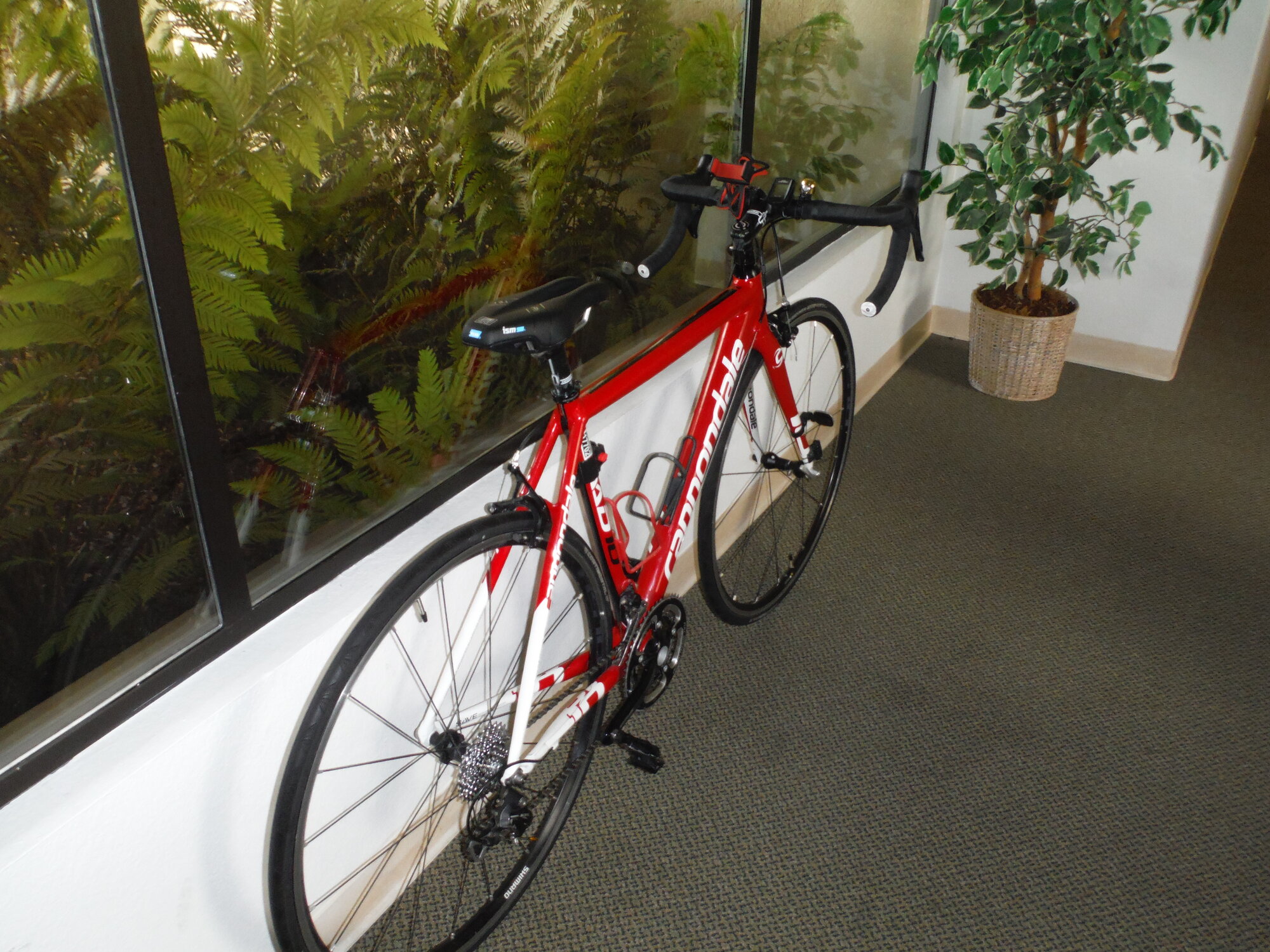

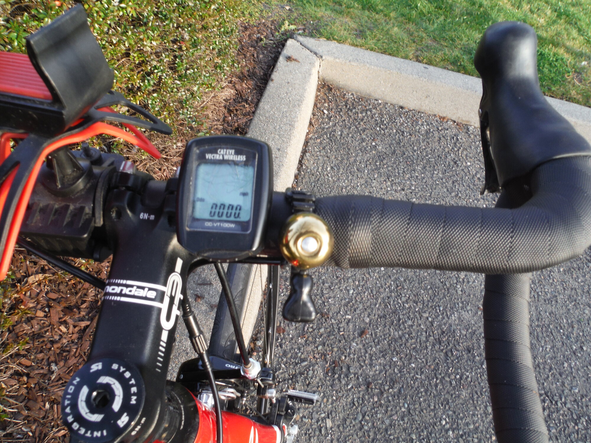

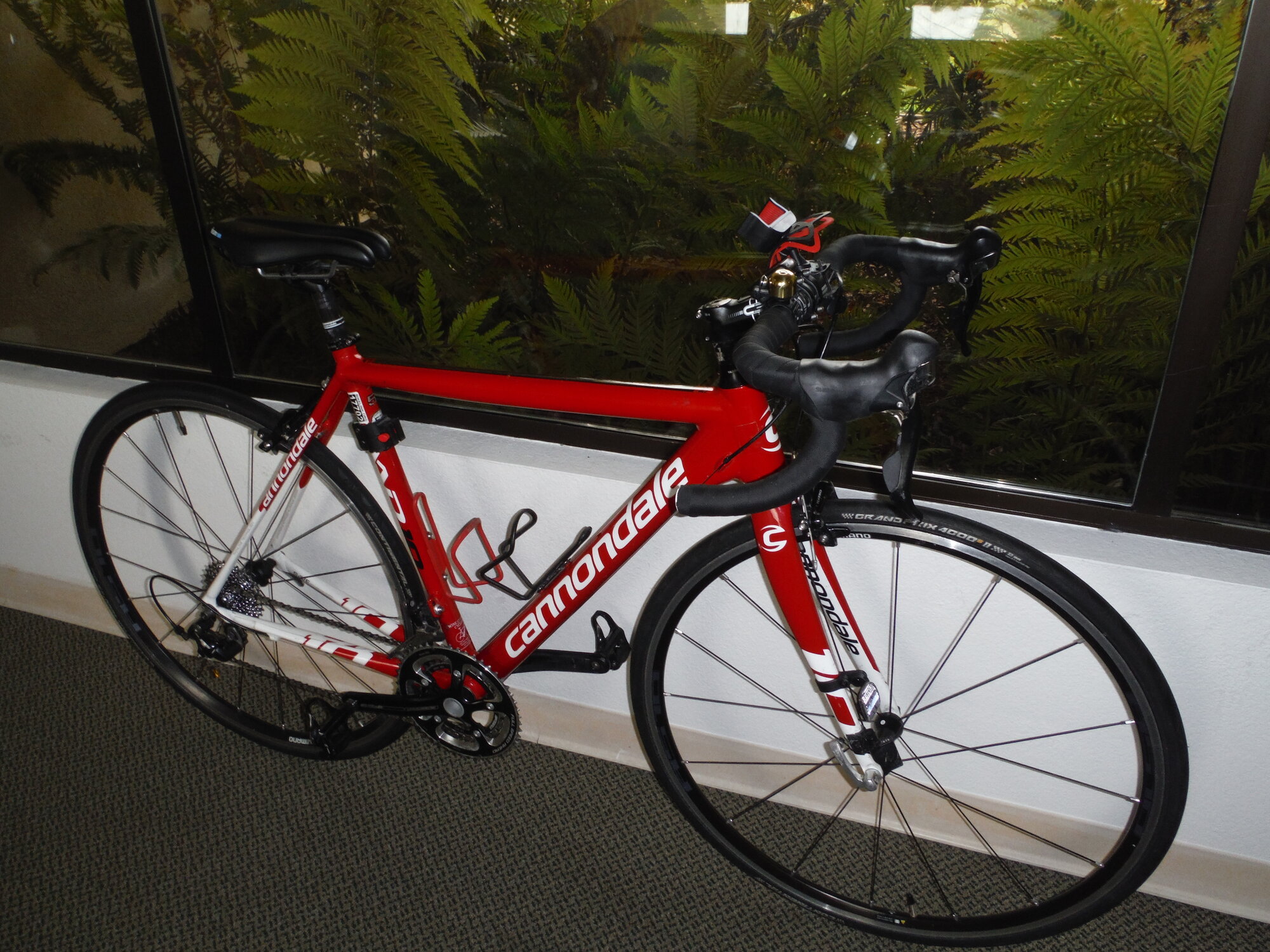

One advantage of upping the chainring over the freewheel cluster is less wear. Force is not as concentrated. Hey, here is a thrashed 8 year old road bike I fixed up yesterday when others were yelling at their TVs instead. 19.2 pounds with the new bell. Now this sucker cooks. Stefan's goes 15. That's it. This one is more that twice as fast without a motor.
