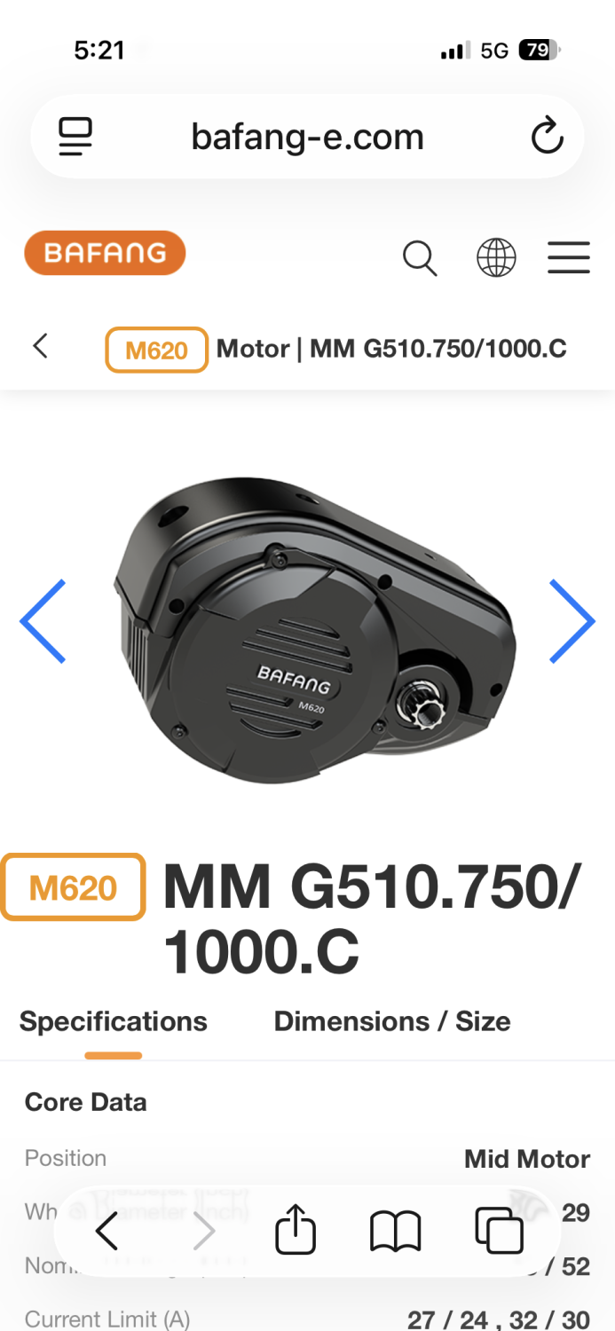

Does any know if a Bafang MM G510 1000w mid-drive motor will fit in a Himiway Zebra, if not do you know of a 1000w mid dive that will?
You will need to match up the frame mounting surfaces to that motor's blue prints.
Doesn’t look like the bolts would match up.
Perhaps there is a different controller you can install in to the motor. Since this motor is sold as a 750w or 1000w version, it might just be a different controller.
