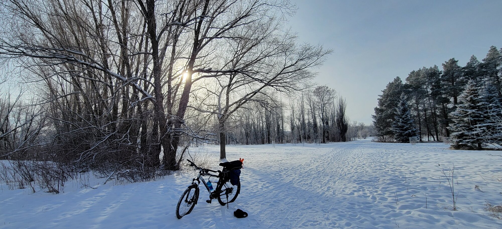

But for me, the Photon is my dream winter commuter. It is compatible with winter tires, which are a
godsend if you plan on doing anything beside riding in a perfectly straight line on ice. You can easily
remove the battery inside and charge it to keep it out of freezing temperatures. I've provided absolutely
everything I know about the Photon: questions specific to the Zen Photon are best directed to Ravi and
his team.

Quick Winter Tips
(flat) ice is overrated. You can handle it (without studded tires) as long as you do not sharply turn or lean
while riding on it: ride in straight lines. Slush on the other hand, is the dark souls of winter commuting:
downshift, use wide low-pressure knobby trail tires, and go slow. I've wiped out on slush waaaaay more
times than ice, and often in the middle of the road too... there's no shame in using the sidewalk if the
road is too dangerous, just be mindful that snowbanks may encroach on the sidewalk and give you (and
pedestrians) less space. Wind is what really makes you cold: cover all exposed skin. Remember to
(slightly) underdress, wear layers, and use ski goggles: you don't think they're necessary, until you
eyelids begin to freeze together and your eyes start to hurt, ask me how I know :)

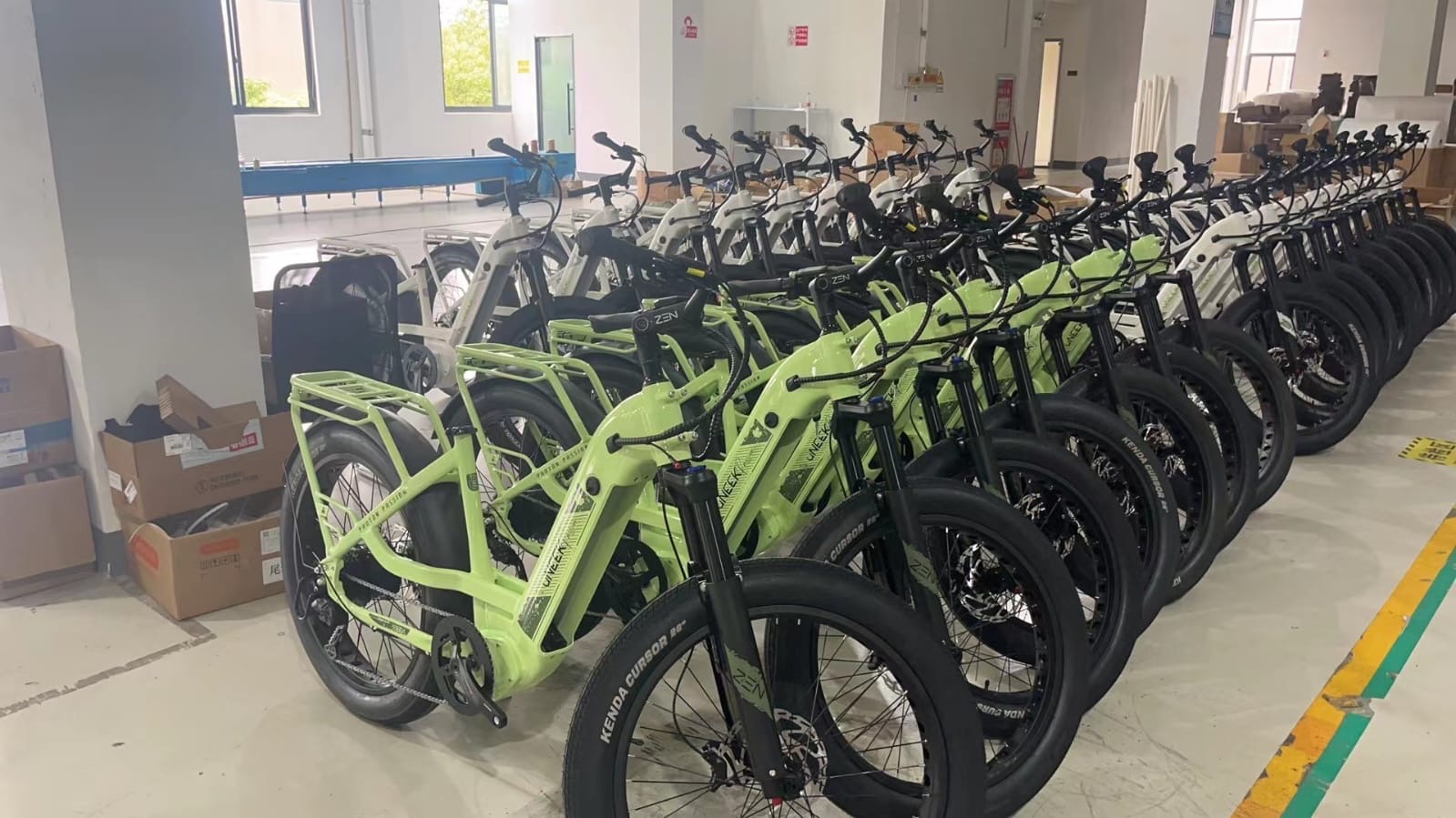

  1. We have found that many people really like the beryl green color, and we are including that in our next batch of Photon Pro bikes.
    So, it would be Carbon Grey, Starlight white, and Beryl Green for colors
