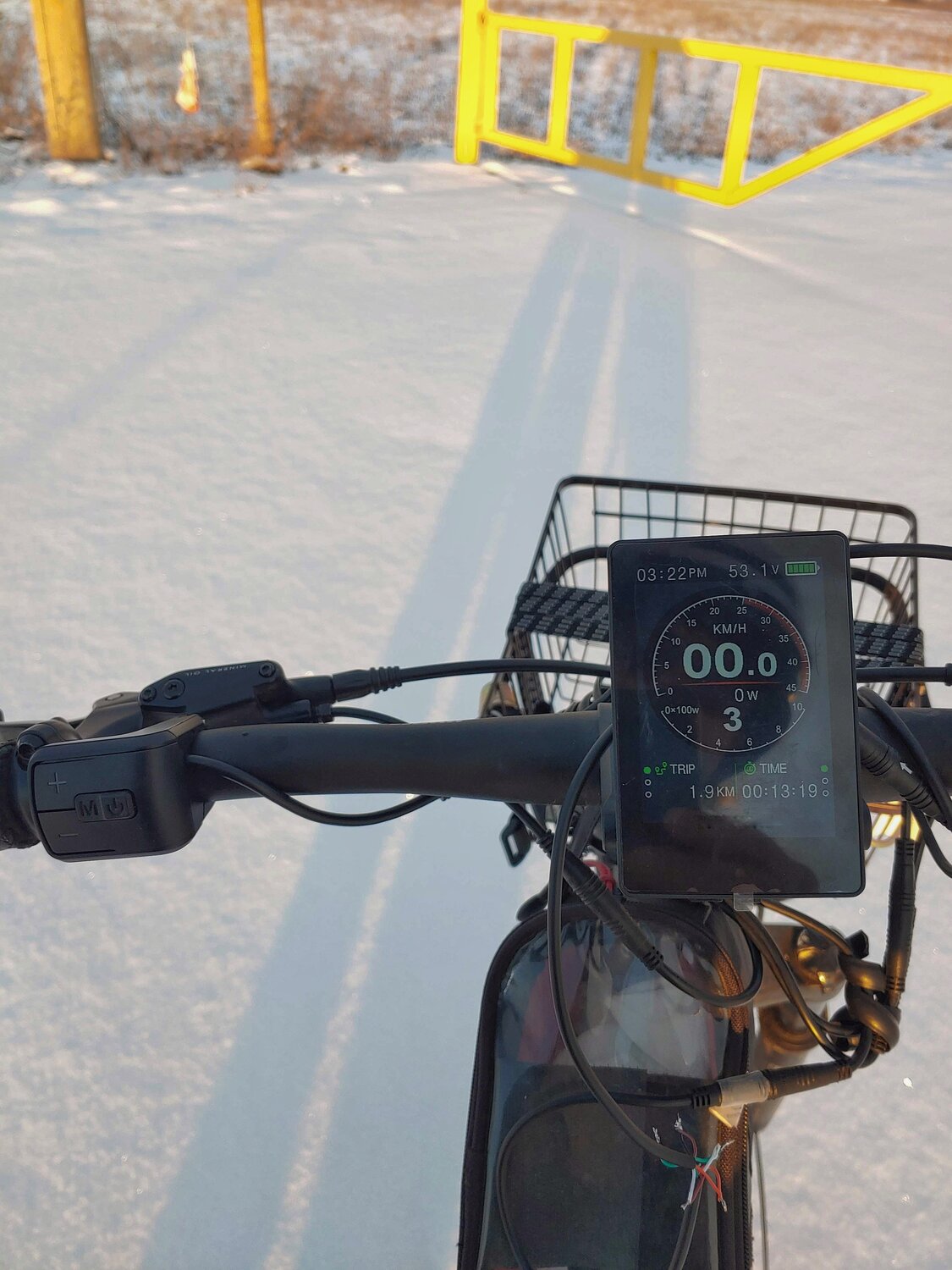

Hi, I have purchased the same display, one model up, an 860C from China for my VoltBikeYukon. It wasn't easy but I have it working. If you still have your display and want help get in touch with me.

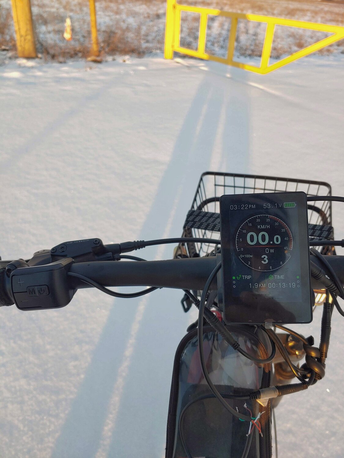

I just received my second 860C, it's been reprogrammed to firmware V1.3D, clock time set and tested on bike. Now to cut the male to male cable and rewire from both ends. Then solder and heat shrink the cable back together and mark both cable ends. Hope my wife enjoys the colour display for her Step-Thru.
