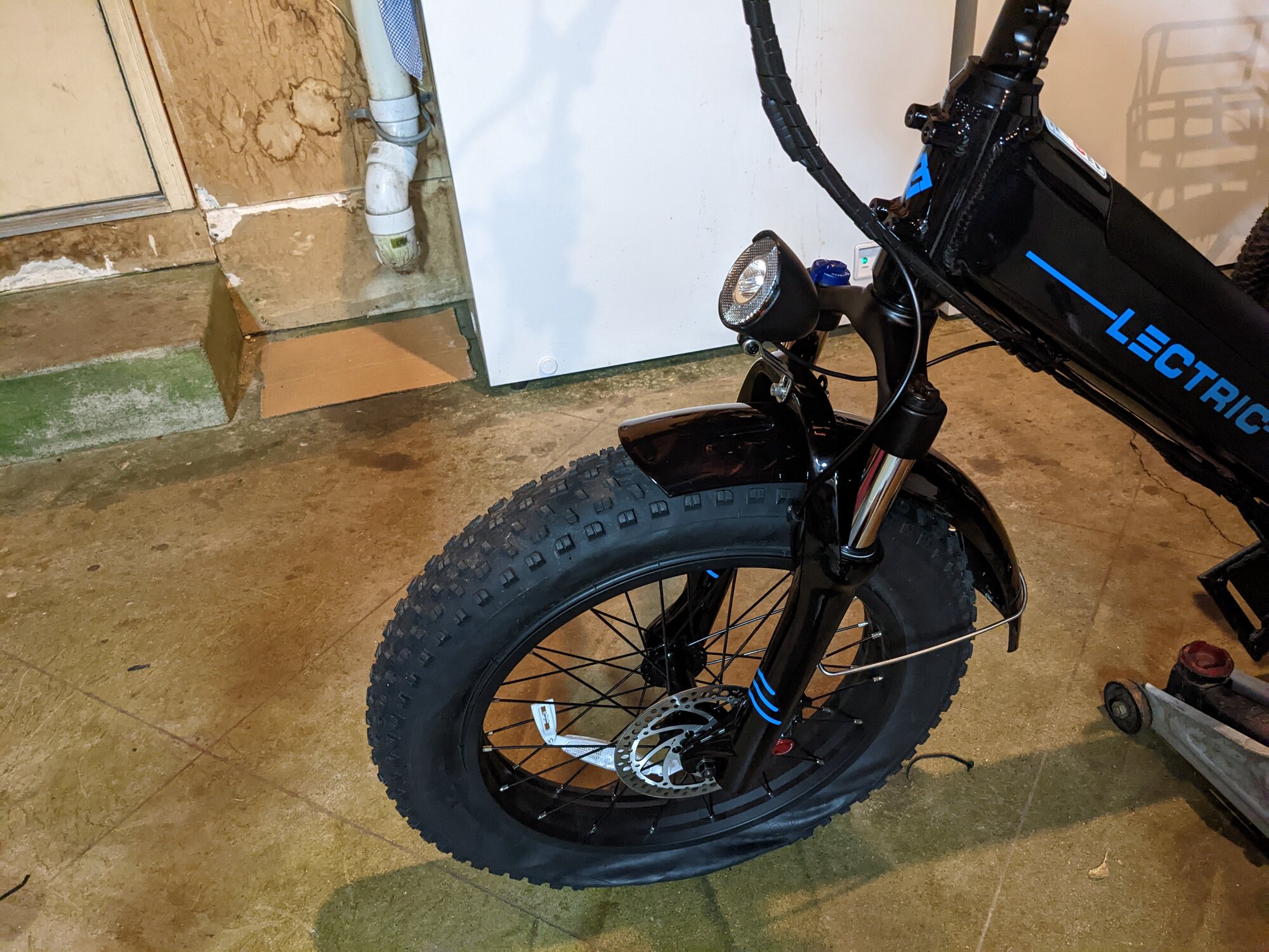

Unloaded my bike from the truck this morning and the front tire was flat. Erik's bike shop did the tannus swap and installed the nickel plated rear sprocket. They were unable to swap my X8 gold chain because it's too short.
Ended up pulling the front tube and notices a small hole about 10" from the valve stem on the outer edge of the tube however nothing sharp inside the wheel at all.
Cleaned everything up took my time and installed a second tube. Pumped up gradually making sure the tire and tannus insert where perfectly centered. Felt good at 15psi. 10 minutes later it started letting out all the air.
Pulled the tube and saw the same size hole on the opposite end of the valve stem and this time closer to 12". Rechecked and can find nothing sharp or that would make a pin hole. Took the wheel and tubes back into Eric's to see what they can figure out.

Generally, a flat tube with no obvious reason that shows up just after a tire service is due to a pinched tube. Either tube pinched between the rim and tire bead, or the edge of the tannus and tire. The tube has to be carefully spread inside the tire, very difficult to do when dealing with a tannus insert.
The LBS I worked at would install everything carefully, then with very low pressure 2-5lbs in the tire squeeze by hand the tire all the way around to work kinks out of the tube, let the air out, work it again around the tire, low pressure back in, work the tire again sometimes repeating the process as many as 10 times increasing pressure each time a little to prevent punch flats with Tannus inserts. A real pain and why the LBS charges extra.

This is the method I tried prior to reaching out to tannus. Tannus tells me they did in fact have a bad batch of tubes that all had a leak near the specific location. She refunded me for the two tubes I purchased however they had also included 2 extra tubes... Beginning to think the 3 tubes could have all been defective.

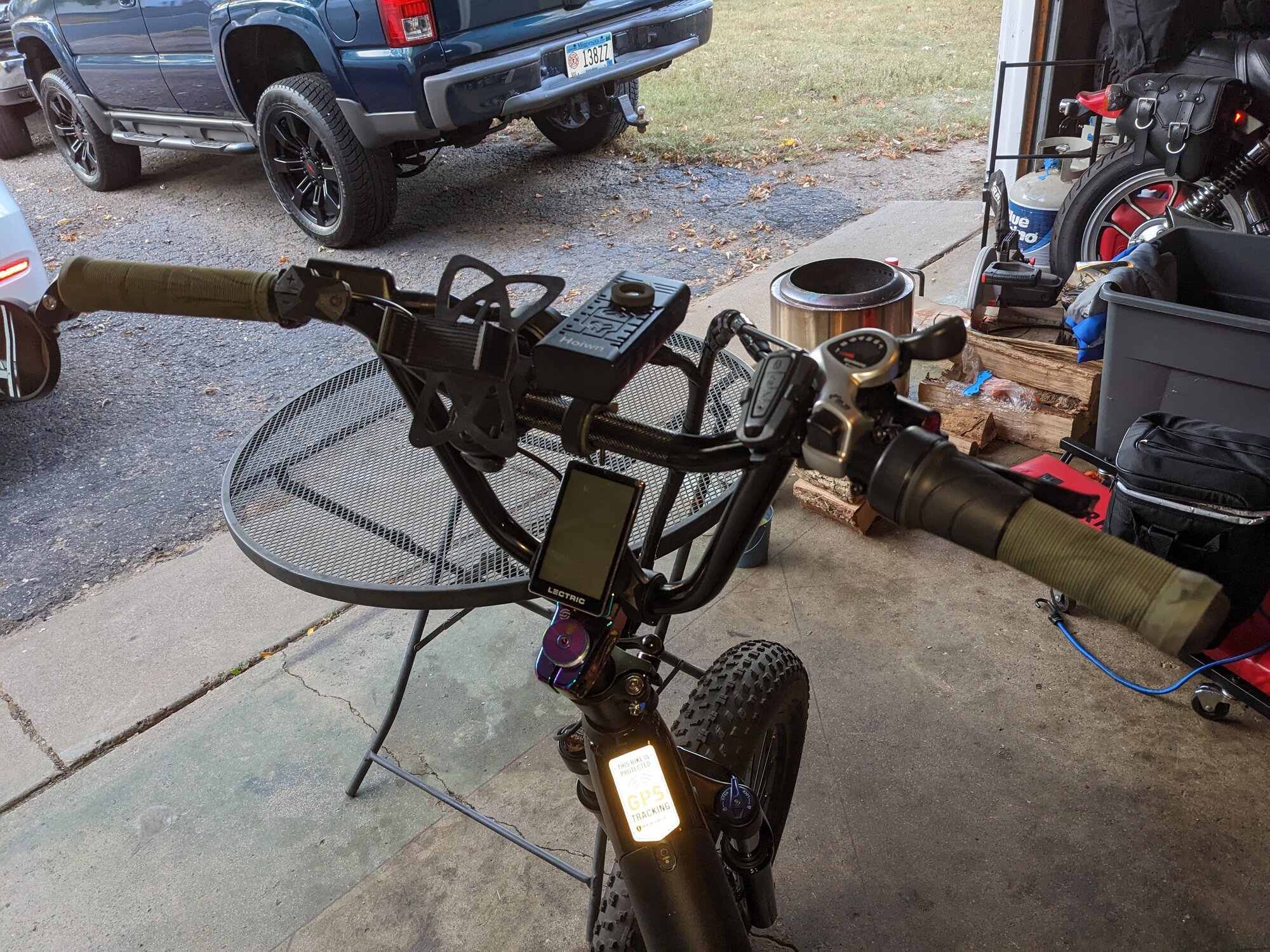

I really like your handlebars. What are they? I'd like to put them on my XPremium.
Thanks. They're 208 BMX freestyle bars with an 8 1/4" rise and 27 1/4" width.
Tried a bunch of different heights on the stem and had trouble getting enough bite at the headset. Ended going with a turtleneck stem on both Lectric bikes as of late which holds firm and the quick-disconnect for the bars is superior to the stock folding setup.
