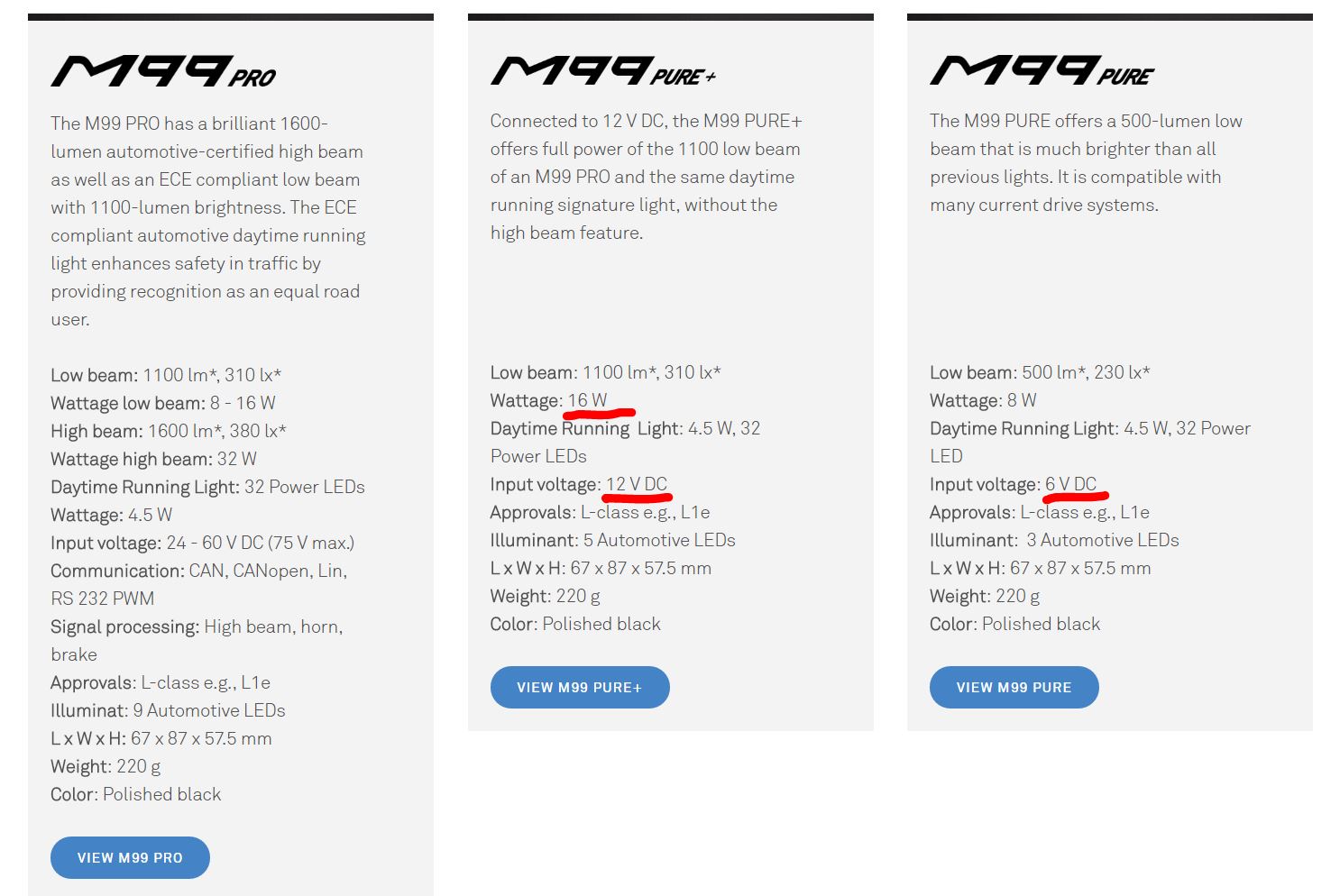

Hello guys. Do you know if is possible to change from 6v to 12v on bosch output by myself? Do I need special cable and software or smth?
It has to be enabled using the Bosch diagnostic software. Only 2017 models have the option of running 12V lights, all the prior year models run at 6V.
Are you sure in 100% that is impossible? :/ I have to return the lamp to store in that situation. That sick, 350 Euro for 500 lumens..
Some bikes have pre-enabled light port and you just plug it in. If your bike is 2017 model, you can run the M99 Pure+, if it's older M99 Pure.
Many bikes do not have this enabled but any authorized Bosch dealer can help you with this.
I have to say, I'm more than happy with the output on the M99 Pure, I'm not sure it is worth the extra $$$ for the Pure+ unless the majority of your riding is in unlit offroad areas. My daily commute is a mixture of roads, cycleways and unlit cycle paths through wooded creeklines. The M99 pure is plenty strong enough, even on the sections along the creek.
As for the argument about the cost, I look at it as a safety issue. I want to be as visible as possible to other motorists, particularly when I'm travelling at a decent speed. To a motorist, the M99 is as bright as a motor cycle headlight. I'm happy to spend extra $$$ to reduce the chance that I will end up as roadkill by some bozo who didn't see me. For offroad riding, I want a good powerful light with a decent spread and depth of beam as I need maximum visibility to react to the path ahead. The M99 Pure is more than sufficient to meet that criteria.
If I hadn't already bought the M99 pure I would probably have considered the Pure+, but having said that, I'm not sitting here regretting my purchase. Buying it from Germany saved me over AUD $100 over the Australian price and the Pure+ wasn't available in Australia or through Bike-Discount.de who I purchased the light from.

Yes, the update changes the light output to 18W max. Before, you were able to draw 6V, 1A-1.5A but after the update the system can draw 12V, 1.5A which is perfect for Pure+ which requires 12V input.
It's a pretty simple firmware update.

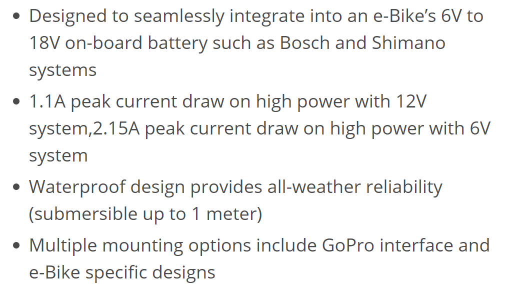

My 2017 Bosch performance line motor EBike came with a low lumen headlight that no longer works so I’m looking to replace it with possibly light and motion NIP 500 or 800. Could I just reattach the new light since it already had a light-therefore light function is already on? Is it safe to assume the light output is at 6v currently and I could easily just use the NIP 500? If I want to use the NIP 800 would I then need to update the system to 12V? Thanks for your input.
Both NIP 500 and NIP 800 works fine at 6V, it is just that it operates at higher amperage.
It may run a tiny bit cooler at 12V. Overall, the NIP 800 would be a significant upgrade to stock lights from most companies.
The great thing about Bosch is that you can actually put a decent light on it natively. It does drain the battery but its nicely integrated. Wish Shimano/ yamaha / Bafang had more powerful light output options.
I understand why it is hard to do though - interference issues and heat issues due to step down converter. May be in the future we will have something nicer.
Thanks much for the feedback. Would it be safe just to plug in the NIP 800 light without first checking voltage using the Bosch software? As I mentioned it already had a low lumen light. Just wondering if by chance the voltage would be set at lower than 6v.
