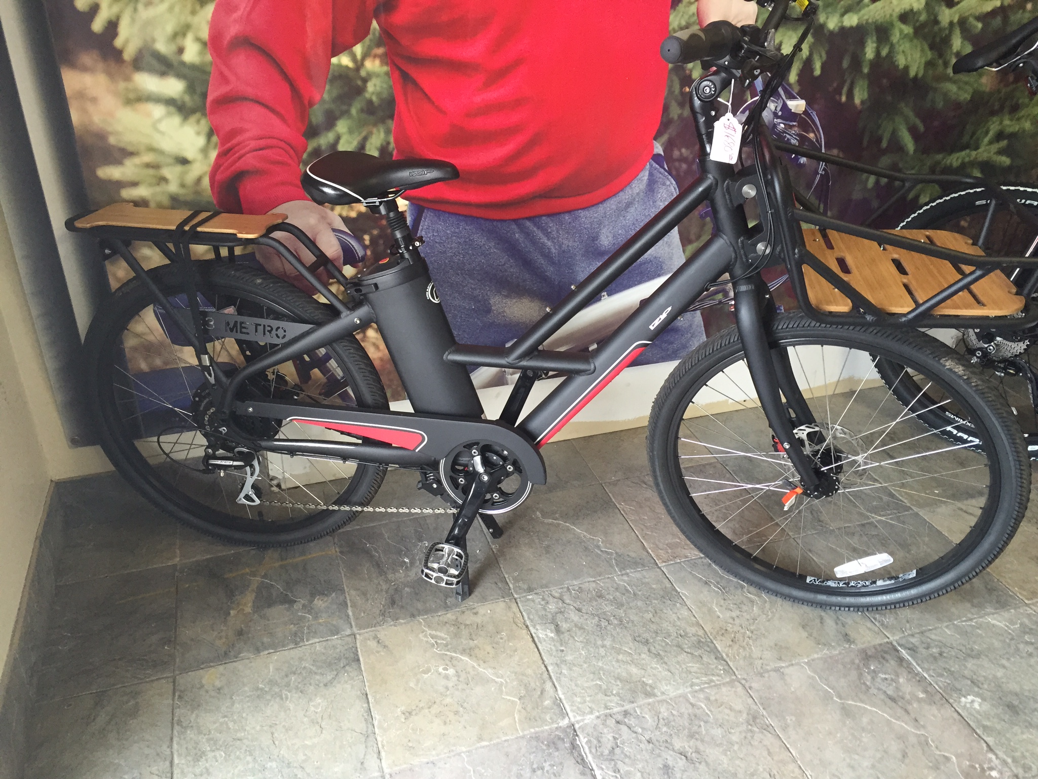

I just looked at the one on our floor and noticed that it has a 48V battery ( 2014's had a 36v battery, 374 Whr). So it's 417Whr now (~20% raise). This is a big difference and really helps in carrying 60+ lbs cargo
Some other minor cosmetic changes. Attached picture for you.
Hmmm. Thanks for taking the time to check this out for me. So I think the black/teal is 2014 and the black/red is the 2015.
