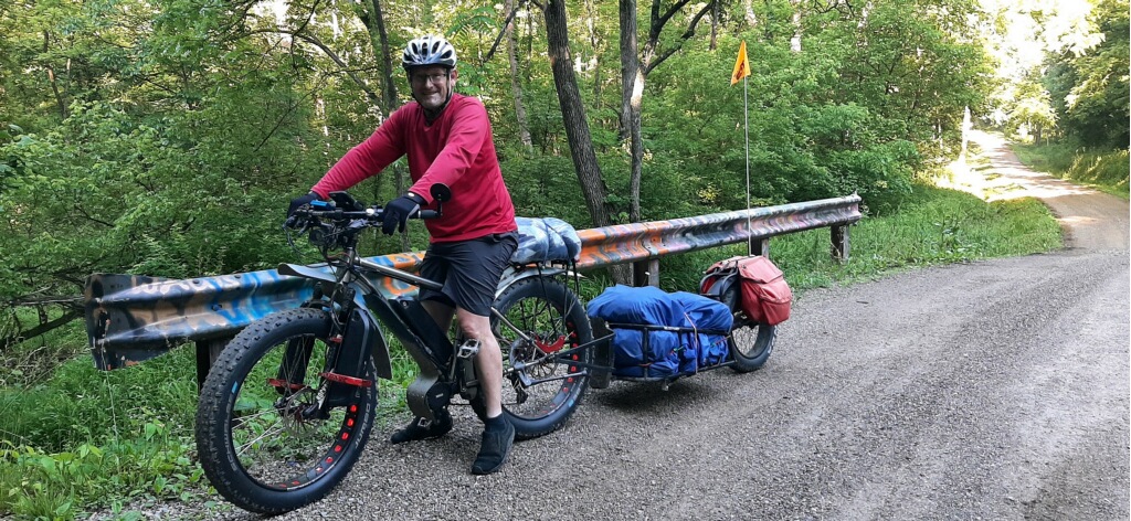

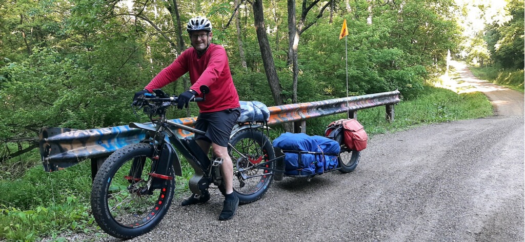

I guess when you take a break from these forums and come back in you have to get reoriented because you come back in with you latest bias. Yeah I am one the outside of the curve. the components vary from XO to GX level and the weight is not within commuter range.What are you trying to do that makes an e-bike so inadequate? Ride it on a highway? A bike can easily accomodate typical cargo loads of 25-50 lbs for one person, plus cargo bikes can haul a lot more if needed (but aren't really necessary if your children have their own bikes or you shop for groceries more frequently as is often typical).
Most of the complaints like this about e/bikes stem from people complaining about suburbia designed around cars and high speed travel. Sorta like complaining you can't breathe underwater. Well, yeah Sherlock lol.
Lol yeah... That isn't typical usage.I guess when you take a break from these forums and come back in you have to get reoriented because you come back in with you latest bias. Yeah I am one the outside of the curve. the components vary from XO to GX level and the weight is not within commuter range. View attachment 90958
425 lbs total, 2,538 watt hours of battery. Off pavement long distance use. 18-20 mph speeds. Many 20%+ grades.
