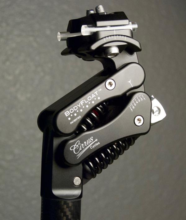

Its all about the seatpost. Some are easy others not so much. My Kinekt Body Float suspension seatpost has two allen screws that you loosen, adjust the angle and tighten. There are marks on the curved post top and a single mark on the seat clamp that you take note of and can always set back to the same angle easily.

Your seatpost clamp is a department store variety. Measure size of the nut and buy a wrench on this exact size, will be easier to adjust. Many seatposts use an integrated clamp with allen screw, but it is still a pain, you have to loosen a little and move by one notch at a time. Lower-end integrated clamps don't have notches marked on the side like Body Float.
I completed two commutes to work (64 miles) on my new bodyfloat. It was like riding on a full suspension mountain bike. My only regret is not buying one earlier.
