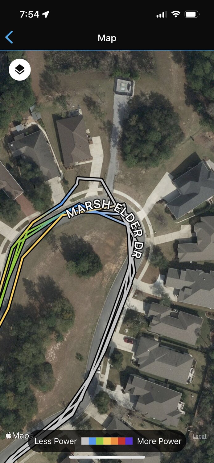

Crikey, probably my last ride of the year and I over cooked a tight corner that I have traversed hundreds of times. I wound up on my back on a nice soft patch of grass with the bike more or less on top of me. I traverse the street counter clockwise. The only damage was to my pride because my err was witnessed by several people who dashed over to check on me. I regained a tiny bit of face when I used the walk along button and the tilted kickstand to down shift to a lower gear, the mishap was at the botton of a hill. The onlookers thought that was a cool move.
Glad you weren’t hurt with your minor crash. And you were able to regain your “coolness” afterwards. Stay safe out there.
