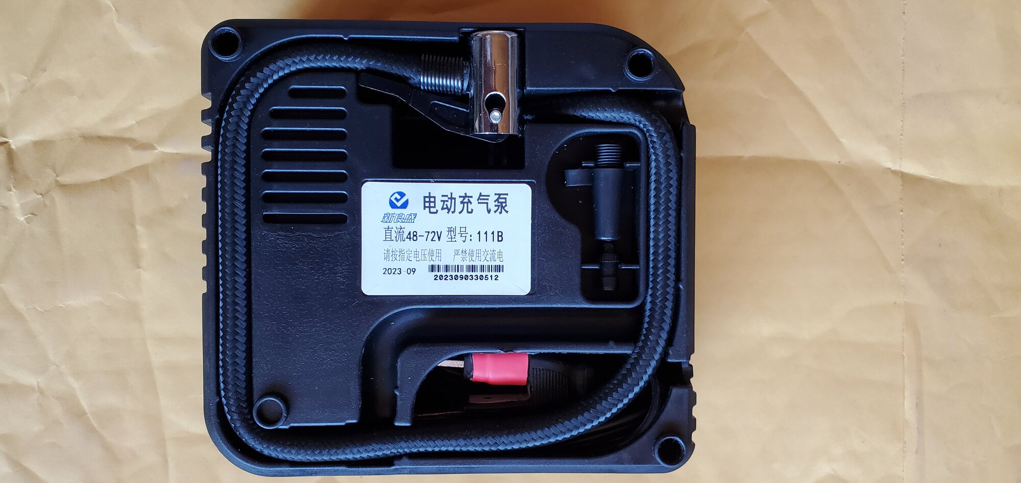

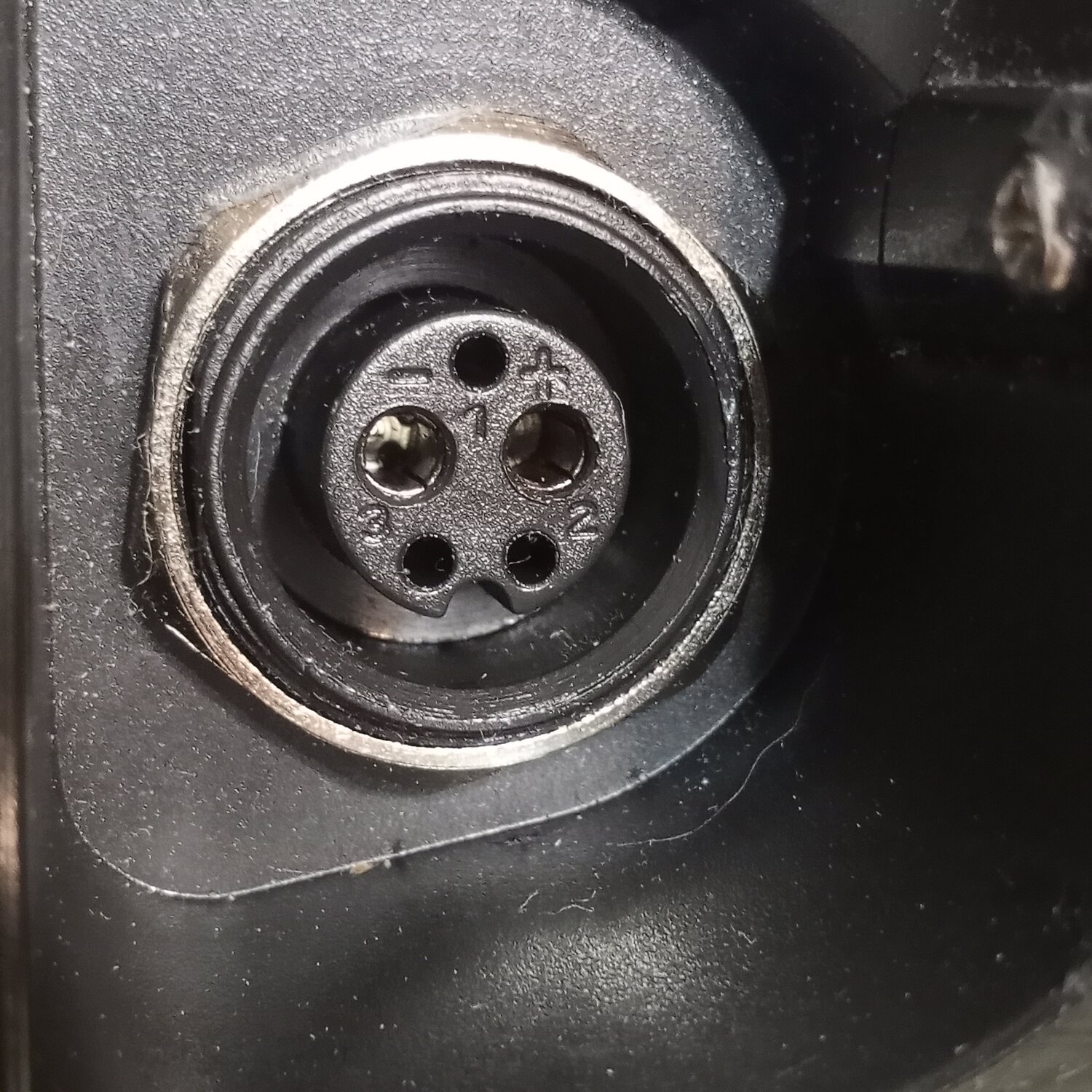

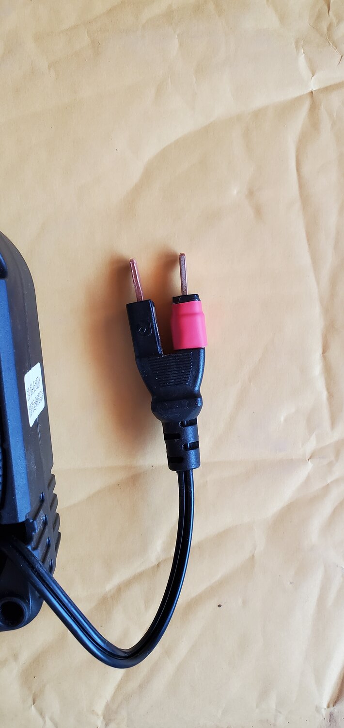

My new air pump for the 48 and 52 V batteries just got here, it is this model,
It has the goofy plug on it, so I made a couple of brass prongs that fit the plug and pressed them into the slots, I also split the Oem plug to fit the spacing for my Hailong 4 and 5 pin batteries.
All I need to do is figure out which side of the plug is the Hot and Neg sides.
I don't want to let the magic smoke out of my batteries while finding out.
I did notice that the OEM cord does have a ridge on one side and smooth on the other side.
I'll mark the hot side with red shrink tubing, to make sure.

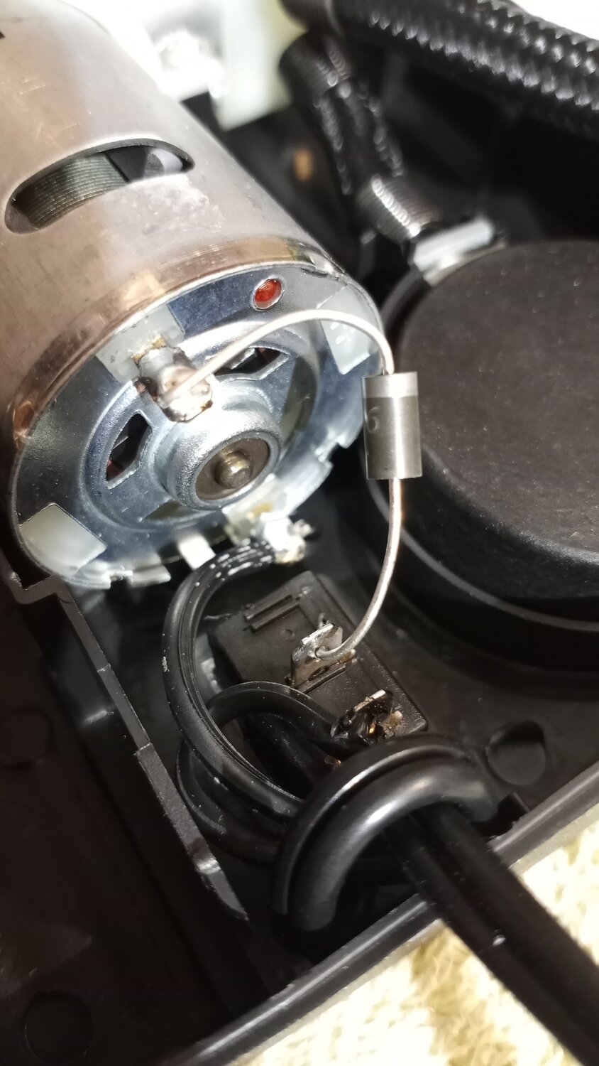

You're fine. Just plug it in and see if it works.
There's a diode inside the compressor, so it only runs if it's plugged in the right way.
It doesn't work and causes no harm if you plug it in backwards.

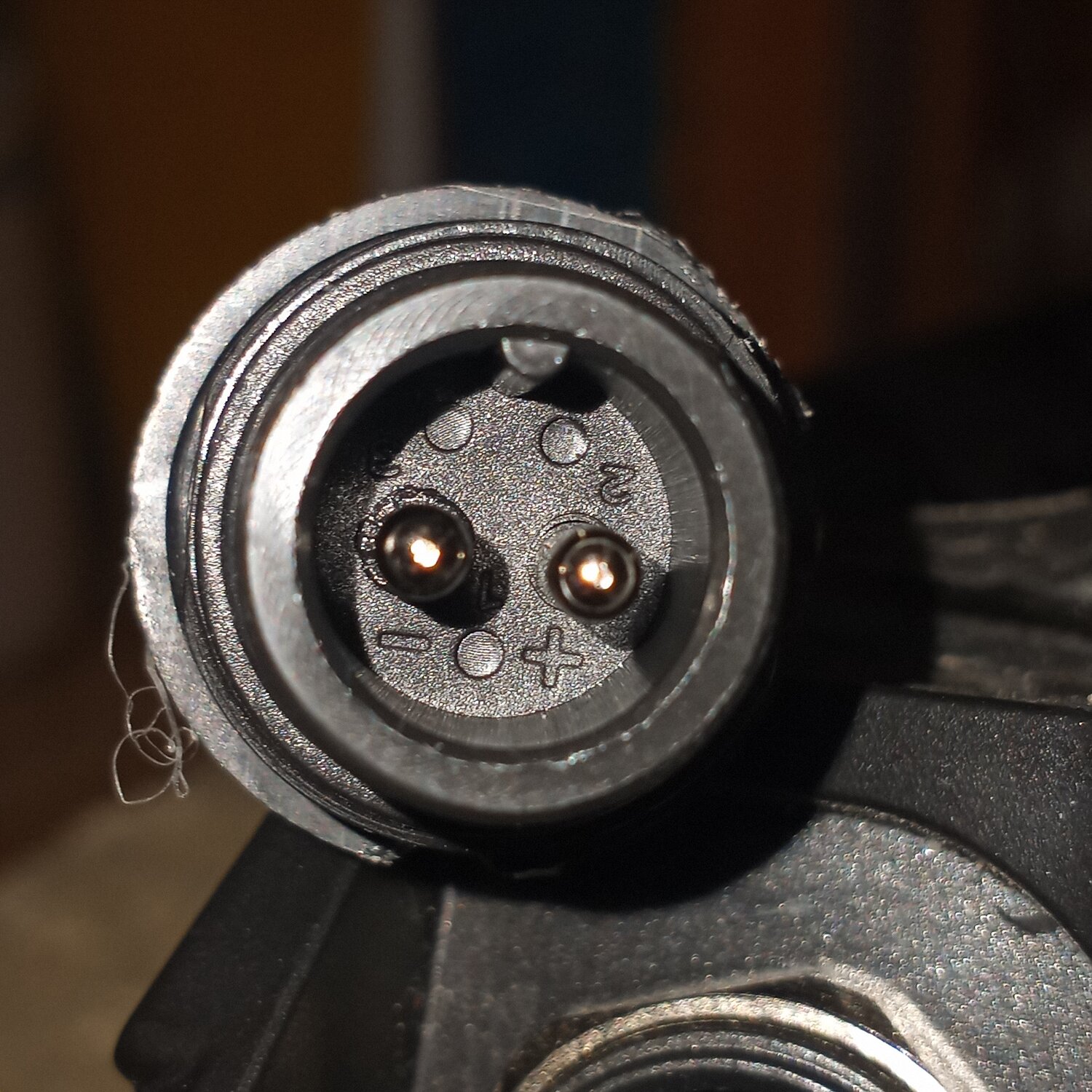

I plugged in the pump and checked the polarity.
It is written on both the battery and the plug.
I also checked it with my voltmeter.
The smooth wire is definitely the Positive or Hot wire.

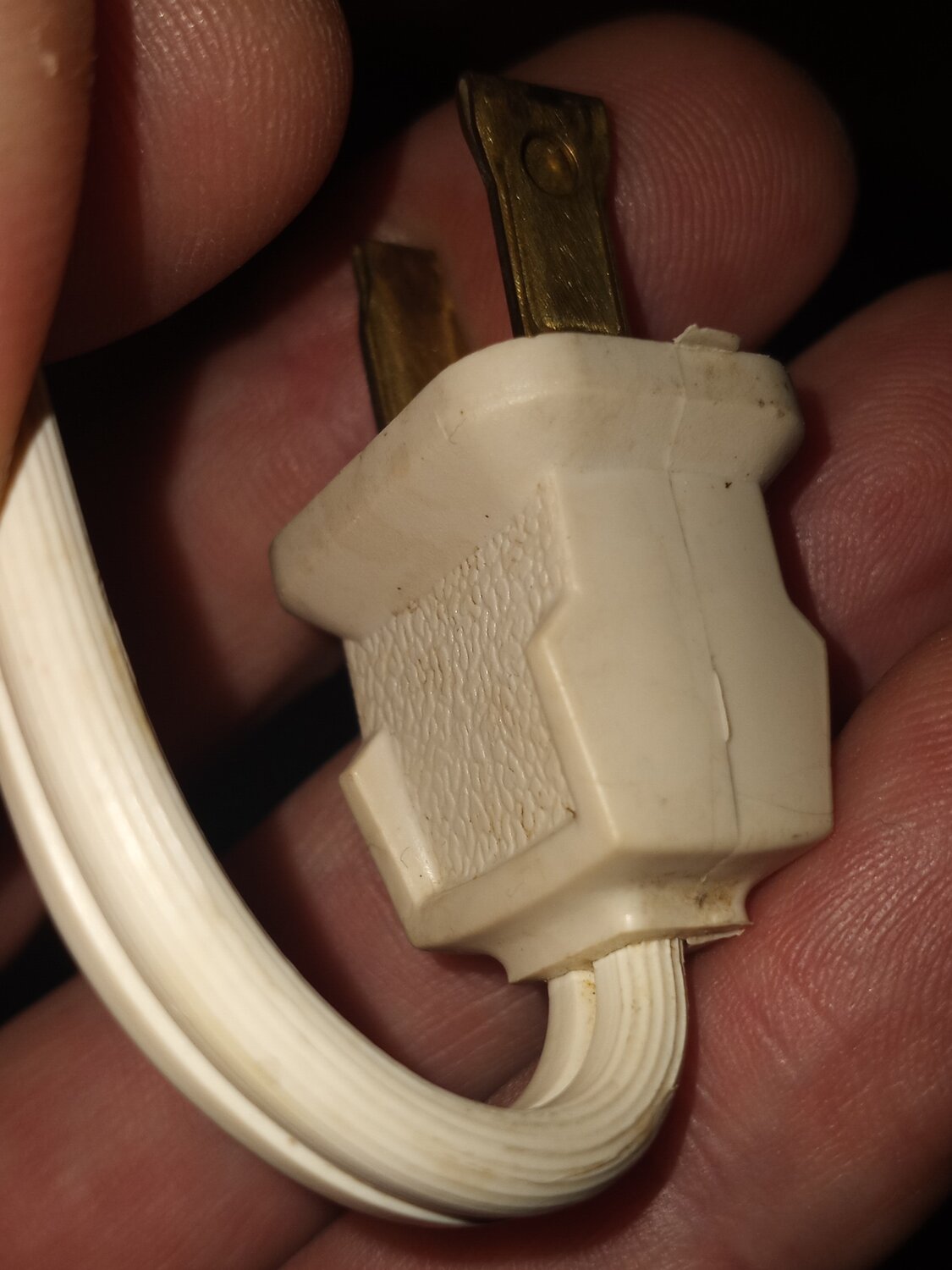

I also checked my Polarized extension cord and the Line (or Hot) wire is also the smooth wire.
I also checked the AC voltage at the outlet, and got 120 VAC between Line (or Hot) and ground, and no voltage between Neutral and ground.
The Line wire is smooth and connects to the smaller bladed prong on a Polarized plug.

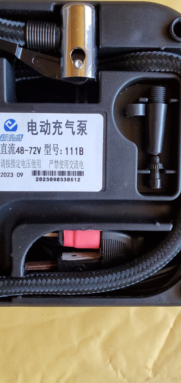

I just checked and tested the pump and it did work,
now the Pos side is marked with a Red heat shrink tube on that side.
The smooth side was the positive side.
The pump is outstanding and moves lots of air.
I now have one for each bike that will stay on the bike,
no more swapping back and forth or forgetting it on the rides.

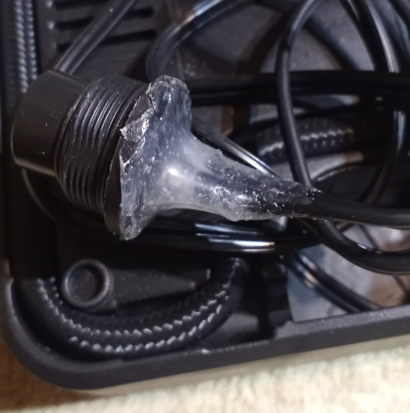

Here is a couple of photo's on how I converted the OEM plug to a standard type US plug to fit my Hailong bike battery's, and the OEM plug fits inside the pump case.
