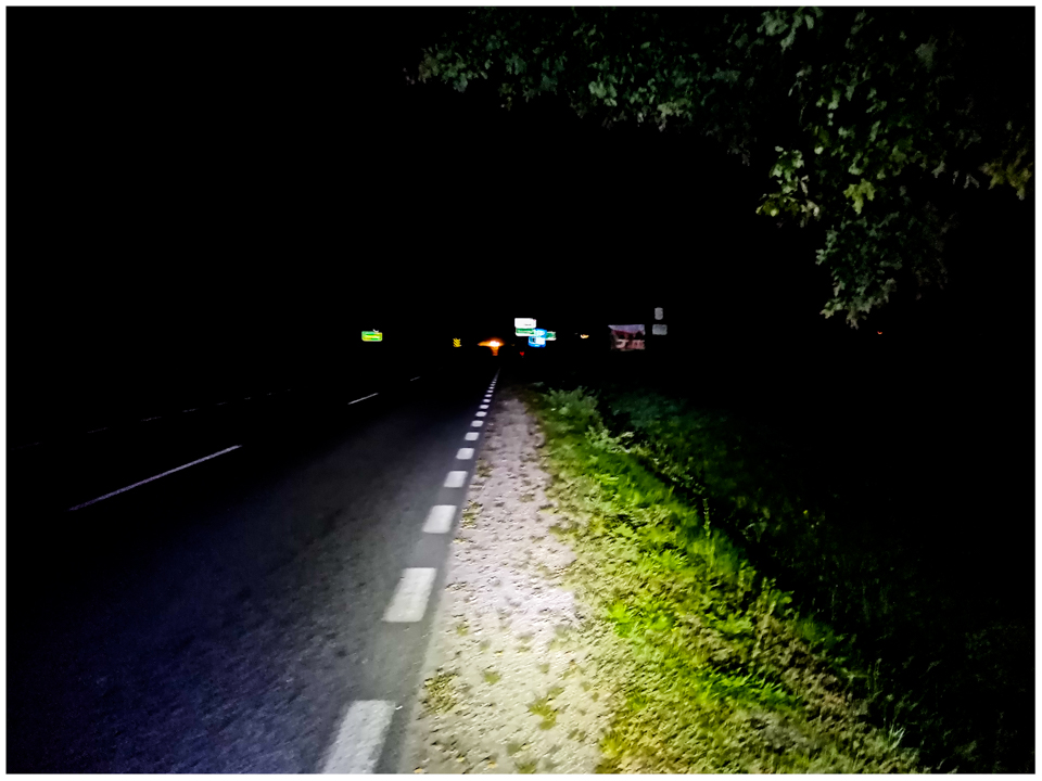

Now, in need to have external lighting on my touring e-bike, I bought CatEye AMPP 1100. Nice, powerful lamp, lighter than the Volt 1700 but unfortunately far shorter battery life. Still, three times cheaper than the Volt 1700.
CatEye AMPP 1100 at the mid-beam setting (800 lm).
Wow! Maybe when I was a kid I would ride that road in the dark no problem (with my old Ever Ready bike lights) but Australia has made me soft and age has made we wiser (or at least more experienced). I prefer a nice dedicated bike lane at the side of the road and I manage it all with two lights on the front and three on the rear (including my built-in helmet light) that cost less than $100 in total.
