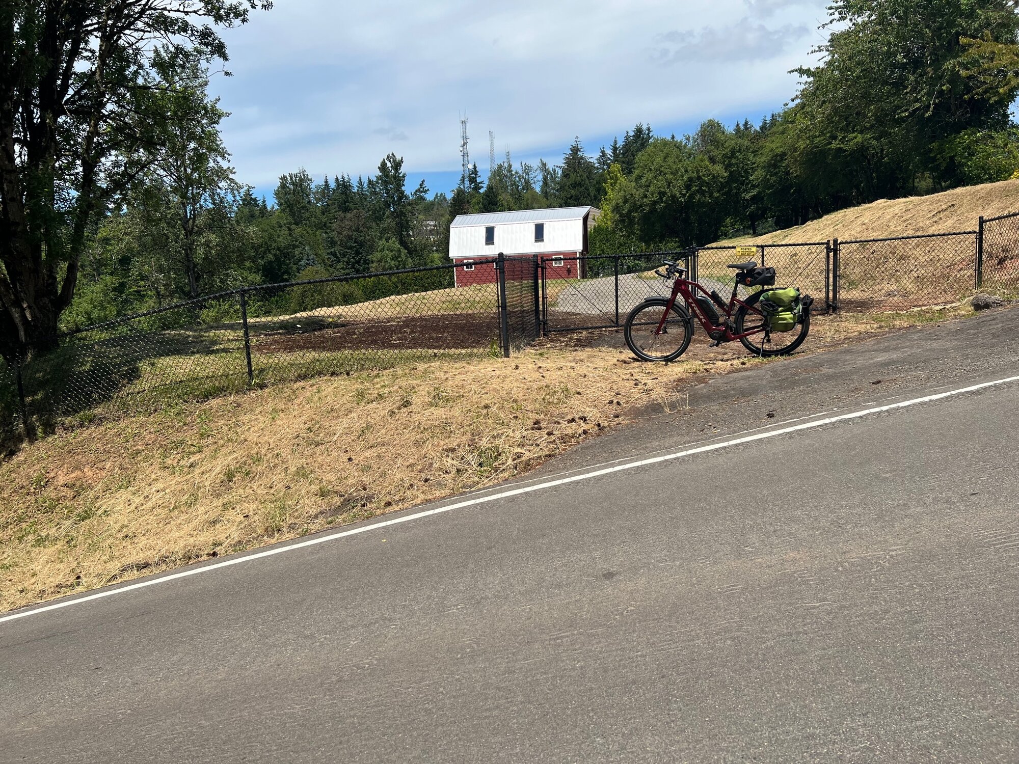

Is the 250 watt motor sufficient to get up fairly steep and long hills? I weight 175 pounds.
How is this? 18% grades take some work but I can do it in eco this is 22% and I can just get up it.
