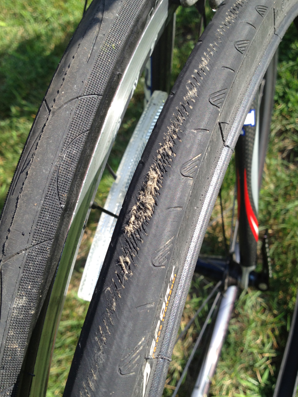

It's not a mileage thing -- not directly -- it's really a matter of what the tread looks like, where you ride, at least to some extent, your riding style, and when you're ready to spend a few bucks. Tires are pretty cheap per mile so don't wait too long, but if they look okay they probably are.
TT
Before they look like the one on the right.
