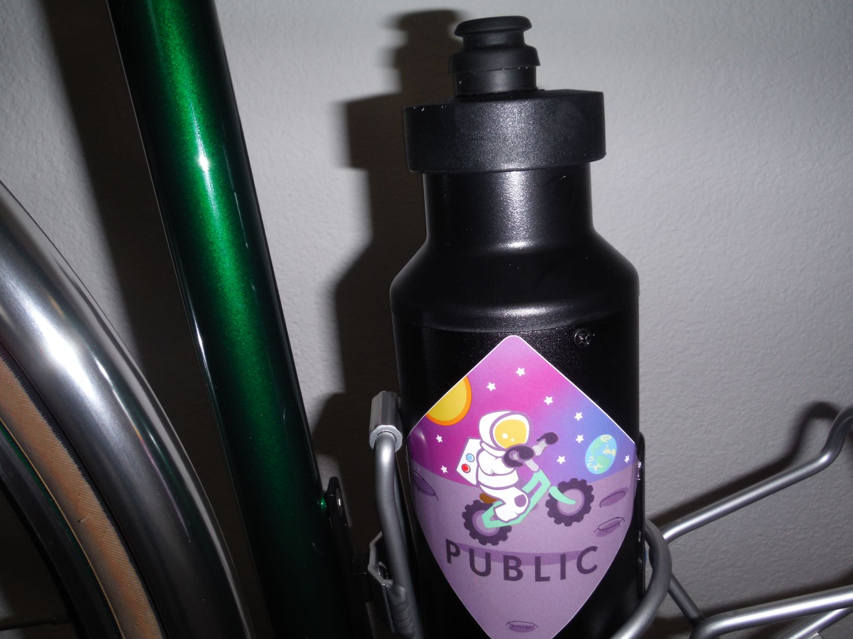

I generally use a mounting system that allows me to use a battery that is the smallest that I can get away with for a given ride. This cuts down on weight. I wouldn't take a ten-gallon bottle of water on a hike up a hill when half-a-liter will suffice. If you only use the last 20% of a given battery 2% of the time, then it is way too big. I put the throttle in the pedals and just push down to go like in a car. Here is one of my electric bikes. I put a bottle top on the battery for fun. Sanyo, Samsung and Panasonic make good cells also. Good cells have much less sag.
