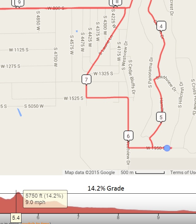

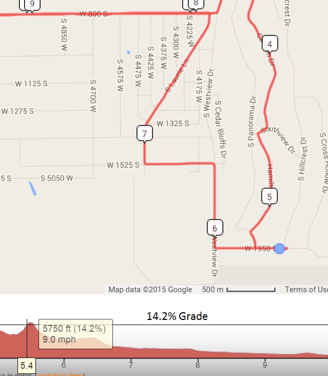

I found the absolute limit of my Mac 350W motor. It will climb a 14% grade if I pedal at my absolute limit and approach the hill carrying some speed, like 11 mph or so:
This shows the Ride with GPS screen print. The App shows the grade and speed at every point in a ride.
If you want to climb serious hills with a hub, those are the rules. Start with speed, pedal hard.
