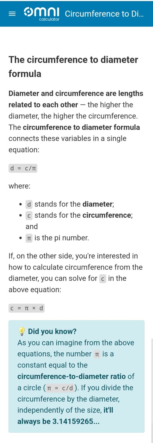

From @PedalUma , I learned to measure actual wheel circumference and divide by pi to get actual diameter. Put the rear wheel valve stem at bottom dead center and mark the underlying spot on the floor. Then roll the bike straight forward till the valve comes back to BDC and mark again. The actual circumference is the distance between marks.

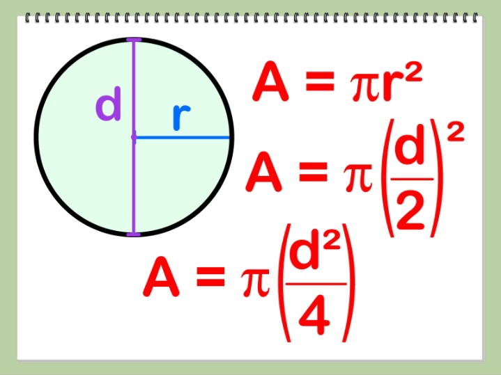

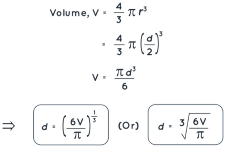

You're correct, D = 2 R = C / pi. Didn't mean to imply differently, just wrote sloppily. My physics-trained brain automatically favors radius over diameter in thinking about rotational problems. Diameter is sometimes more practical, though, and most people do the opposite.
Apparently the math is a lot simpler using diameter as well.
I remember watching a 5 minute video a few years ago where the math was done to calculate circumference, area, and volume using diameter vs. radius.
I hadn't taken Calculus since 1983, but I remembered enough to see that the number crunching was A Lot simpler using diameter instead of radius.
Even going into quadratic space and further, the math was simpler.
