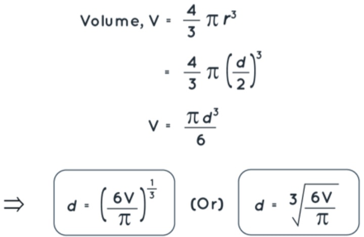

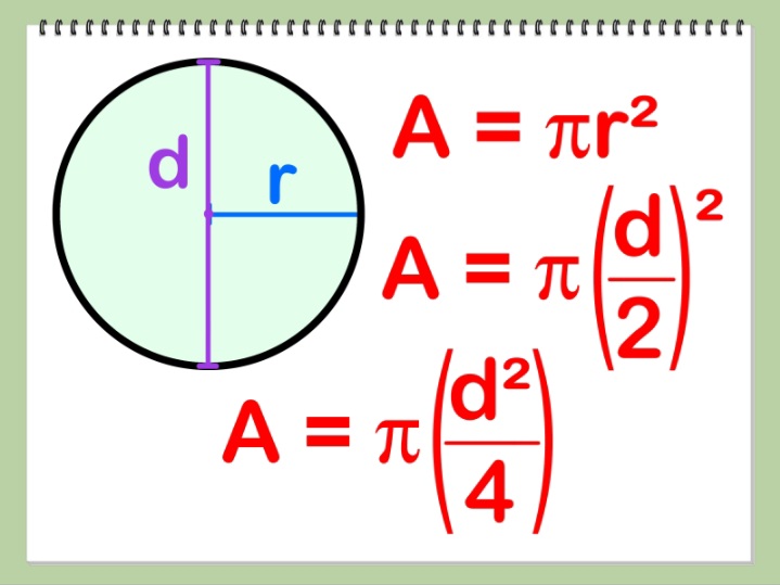

Apparently the math is a lot simpler using diameter as well.
I remember watching a 5 minute video a few years ago where the math was done to calculate circumference, area, and volume using diameter vs. radius.
I hadn't taken Calculus since 1983, but I remembered enough to see that the number crunching was A Lot simpler using diameter instead of radius.
Even going into quadratic space and further, the math was simpler.
To each is own. When you get to rigid body dynamics (the physics of rotating bodies), diameter makes the equations and the thinking messier.
