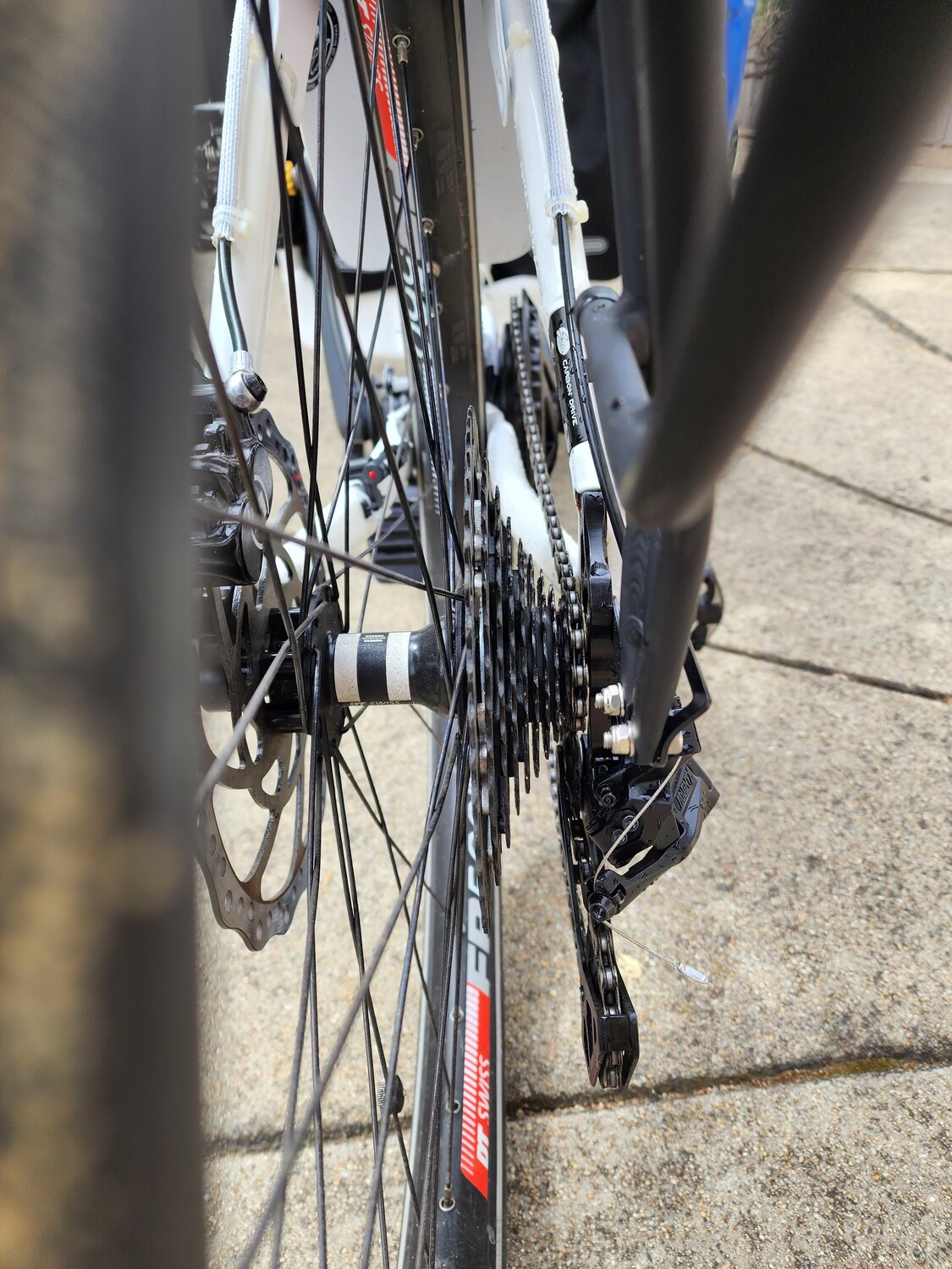

I totally forgot the Shimano Linkglide cluster is an 11s 11-50T. Every reviewer raves about their durability. Myself, since I can get a Microshift steel cluster in 11-46T for 11s, and its only $65 vs. $120, AND my chain alignment keeps me from using the smallest and largest cog, when I look at my usable gears I see almost no difference in cog teeth.

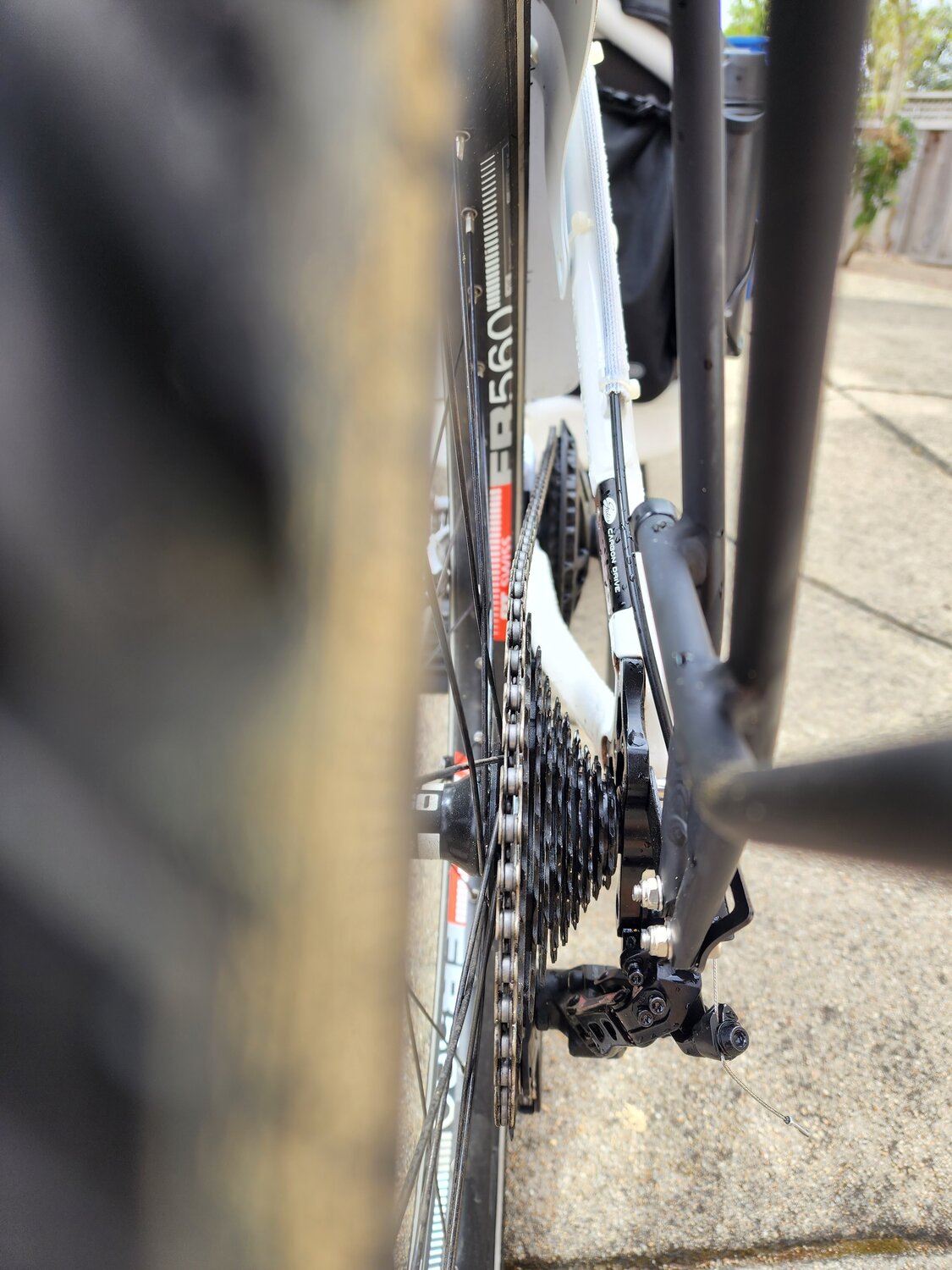

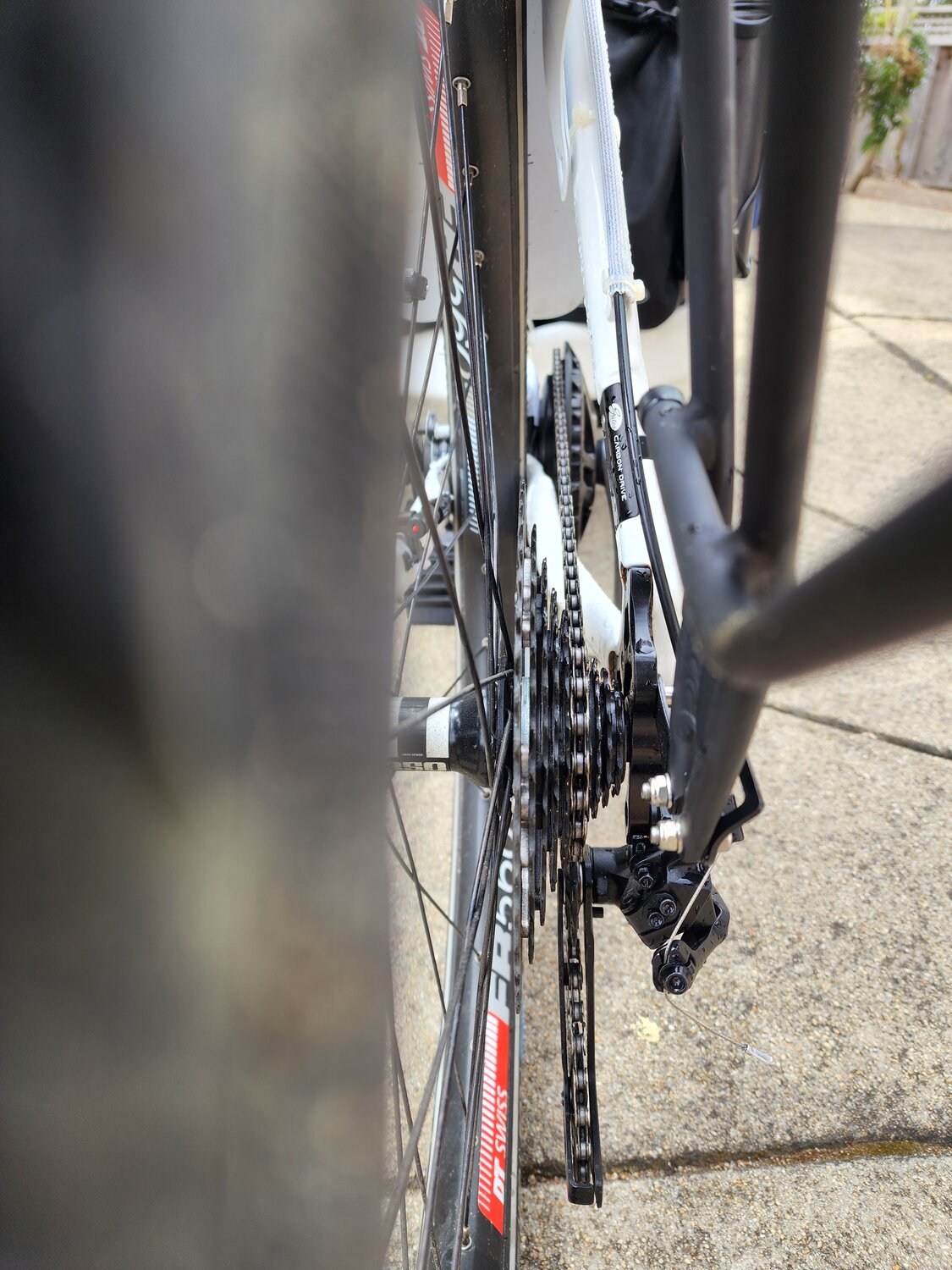

This is a bike I ended up doing 10s on. But my green bike with 11s has the identical chainline issues. This bike is 26" with short stays so the tire is right up against the seat tube. The longer your chainstays, the less of this effect you will see. That is a Lekkie Pro front ring so it has effectively the same offset (22.25 vs. 22.2) as the Luna Eclipse on the green bike that has the same frame.
Chain line on this tight rear triangle is so bad at either end I can't use both the 11 and the biggest 48. I mean... I can use them but it would be stupid to run torque thru a chain skewed like that. So, what if you have the same limitation? That turns your 12s 10-52 into a 10s 12-42T. How does that $200 chainring then compare to a $65 (hardened steel and pinned-together) Microshift? Its a 9s 13-40T. The $120 Linkglide becomes a 9s 13-43T.
12-42T 10s (usable)
13-40T 9s
13-43T 9s
Thats something to think about when assessing whether you want to go 12s. You aren't getting much wider range (or you are losing a little) if your chainline restrictions turn out to be anywhere near typical. Especially since a Linkglide chain - which has so far proven to be strong - is only $25 vs. a KMC e11 which is about $55.
You can get your durability and very nearly the same performance for a lot less money. There is a lot more available in 2024 than there was in 2019 when I needed a mortgage to buy the complete EX1 drivetrain for my Cyc'd 29er.

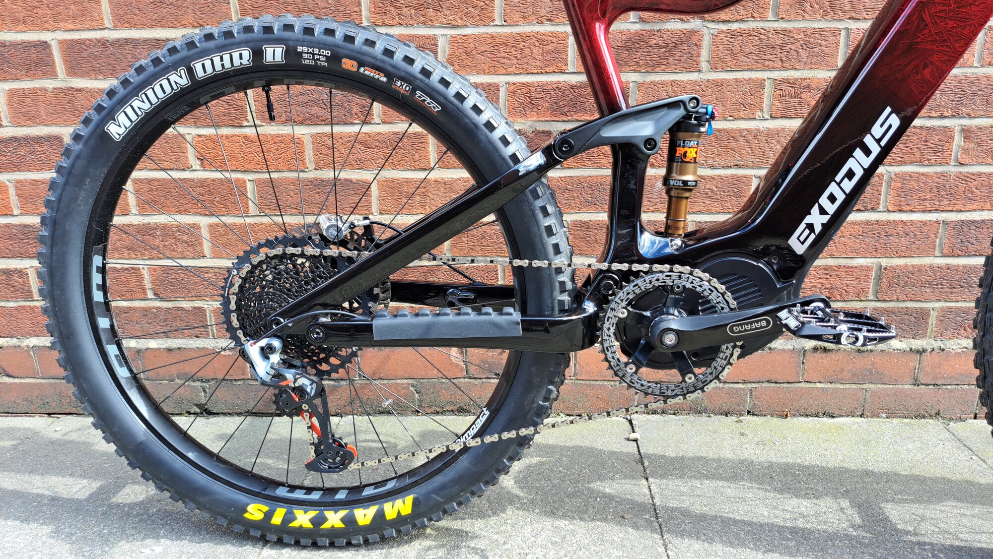

Heres two 12sp
