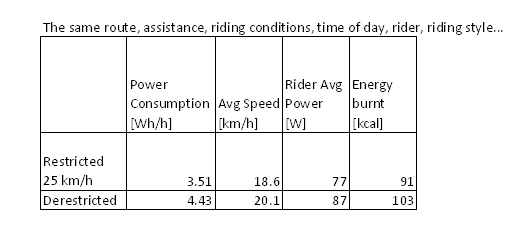

I basically ride the same style (especially on the same route), similar cadence, and my leg power output stays the same, as Wahoo/Strava confirm. My Strava of the tomorrow's morning will produce several metrics including the temperature and wind. Important: It is a loop ride so it is affected by the wind less.
Vado SL 4.0 EQ.
It is worthwile to notice I produced more leg power on the "derestricted" ride. The phenomenon is perfectly familiar to me: The more assistance you get on the mid-drive motor the harder you try as you enjoy the increased speed (and have to counter more of the rolling resistance and air drag). Still, the calories burnt on both rides were almost the same. The "restricted" ride battery consumption on the route was 27 Wh, and it was 34 Wh on the derestricted ride (26% more).
