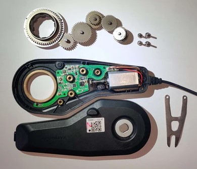

i think someday the b-school case study of vanmoof will be pretty much directly laid at the feet of whoever designed this thing and the logic by which it operates, or the production line/process that made it :
it's purpose is to rotate the gear selection ring of a totally standard sturmey archer 4 speed IGH. the little motor in it turns the splined ring (shown removed at top left) which shifts the IGH. the bike's controller directs it to change positions based on speed or manual input of the bike's buttons.
i wouldn't be surprised if as many as 25% of these in the initial S3/X3 production cycles failed, and many of the replacements failed, and then failed again. it's not a part that deals with high torque (all it does is turn the selector ring 22.5 degrees at a time, from 0 to 90 on the hub) nor does it see any impact, movement relative to the hub, etc. however, the IGH it's attached to does see load, and while i don't know for sure i imagine the result of the gear selector being in the wrong place at the wrong time under load is not so great for the IGH. the first bike i had just didn't shift out of first after a few rides. replaced and it was fine for a while. then i was bombing down a hill in fourth, probably going 35+ and pedaling hard, and the IGH slipped and never engaged beyond 1st again. others had all kinds of different stories about it failing in various ways, cycling through the gears for no reason, etc. it should never have been designed to shift automatically without some knowledge of load (which becomes tricky with a hub drive, the initial design and maybe the current ones don't have a torque sensor!). i think i also had to have the whole electronics cartridge (they put everything together in one part, including the screen, speaker, switches, controller, etc) replaced once or twice, so there may be a similar story there but it was really the e-shifter and IGH that put them in the huge hole from a consumer perspective.
