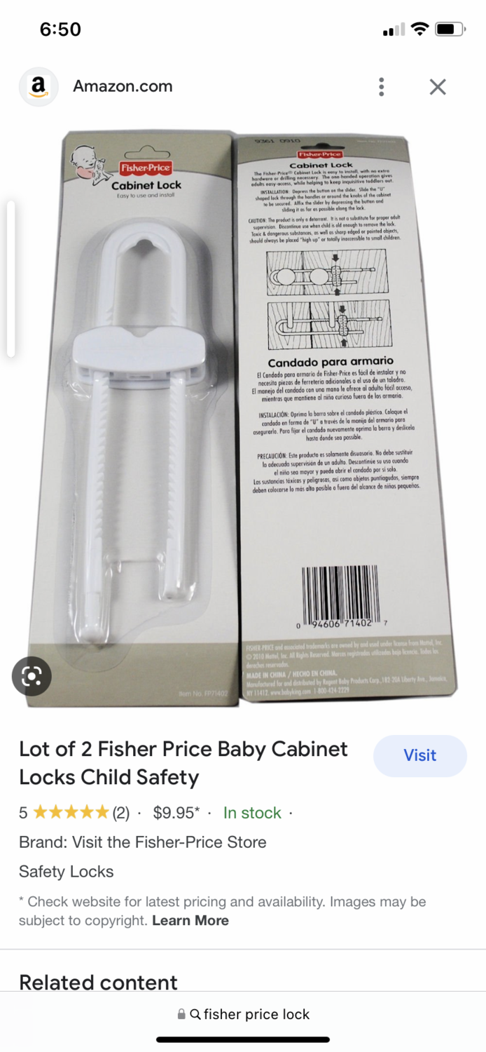

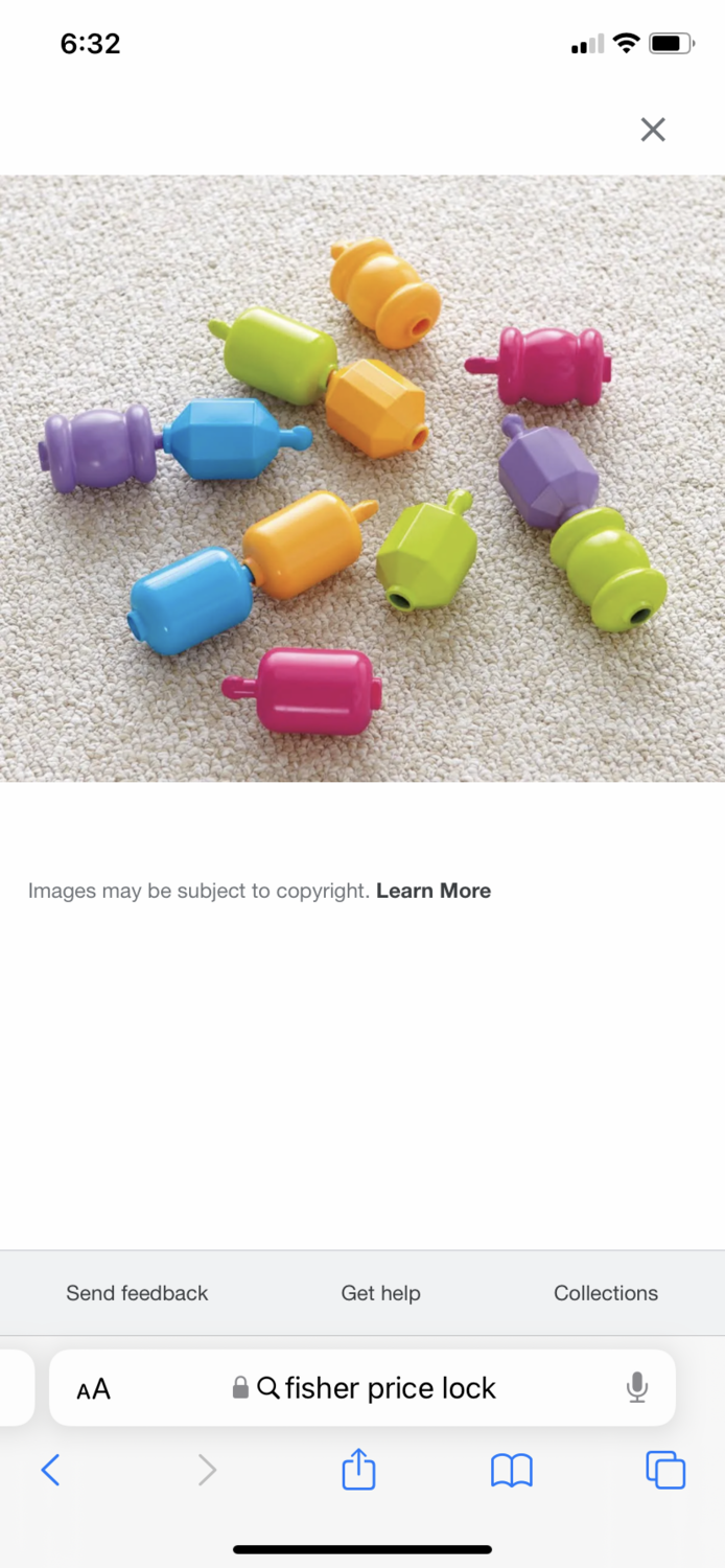

Pink and orange with a Fisher Price sticker on it. That will confuse them!!
Run your cable lock through THIS!!

And this!!
