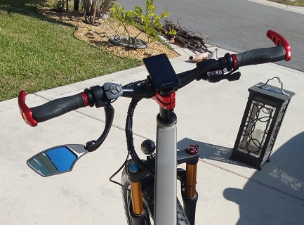

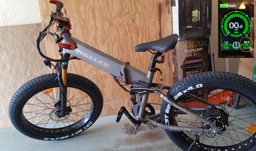

Here's some images of my tweaked X3 Pro:
Thanks for the response. I will be very interested in your impressions. Is this your first ebike? I have about 1500 miles on my first ebike and my wife has the same bike with about half that. We are both enthusiasts. Ours are 20 inch fat tire folding bikes. As you can see from my post and AHicks post, we are both skeptical about the range that is claimed... Nice mirror by the way!!
Yes, this my first foray into eBikes. The last time that I looked at an eBike, was at a brick and mortar and their inhouse brand started at $3K.

Overall, I'm happy with the feature set to price ratio, of the Wallke X3 Pro: 750 watt motor, 8 speed cassette, Air shock fork, hydraulic brakes (only 160 mm though) adjustable reach (with a shorter stem), color display (Key Display, KD718), cruise control, on screen password and no key dangling from the bottom of the crossbar.
Coming from a Big Box Store Mountain Bike, I found the (26"x4") fat tire's inherent resistance to be a non-issue. Very smooth ride over hard pavement.
After changing out the stock seat (for something just a little wider) and the leather grips for an ergonomic rubber set (with 3 finger horns), I found taking long rides very comfortable. For me, the aftermarket grips allow me to alternate my grip, to relieve any fatigue in my fingers.
I've lowered level 1 PAS to around my normal pace of 11-12 mph. This way the motor only kicks in, if I hit a strong head wind or a prolonged incline.
I'm 5'4" and 215 lbs. To address my challenges I replaced the bike stem with a shorter one (31.8/45mm) and lowered the replacement by 10 mm. Also I used the set screws, to reduce the reach, to the hydraulic brake grips. I'm really enamored of the design and adjustability. For my weight, the 750 watt motor, gets the job done., without protesting, when I go full throttle. At age 55, the motorized assist has allowed me to get back into riding.
There is a cruise control feature; which can be set against each PAS level's respective top speed. I swapped the default 3 levels for 5 and customized each level's output. Until I get acclimated to the full power, I only use PAS 1 - 3 (3% - 45%), on a daily basis.
I've gotten the bike up to 29 mph, on a flat surface, with pedaling, under PAS 5. I haven't really tried to measure throttle only yet. The motor itself does appear to be a true 750 watt. As under full throttle, PAS 5, the display shows the output wattage to be just under 1000w.
