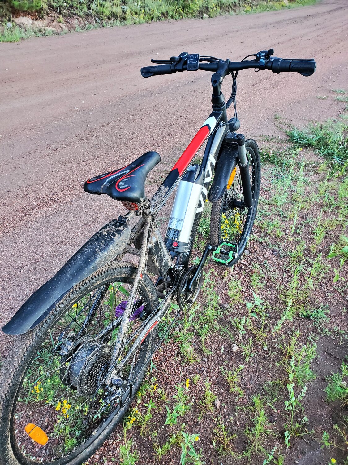

This is the bike, it is 350w 36v 8ah battery equipped (removable) and on full speed it needs help pedaling on hills and runs out of power quickly. I suppose I can just convert my Karakoram (early 90s) to a 750-1000w 48v 20ah front hub set up. In the mean time I'd like to find a 2nd battery so I can go full speed round trip. ViVi is out of stock so I may be screwed for now.
Ok you have enough room for most frame mounted batteries.
