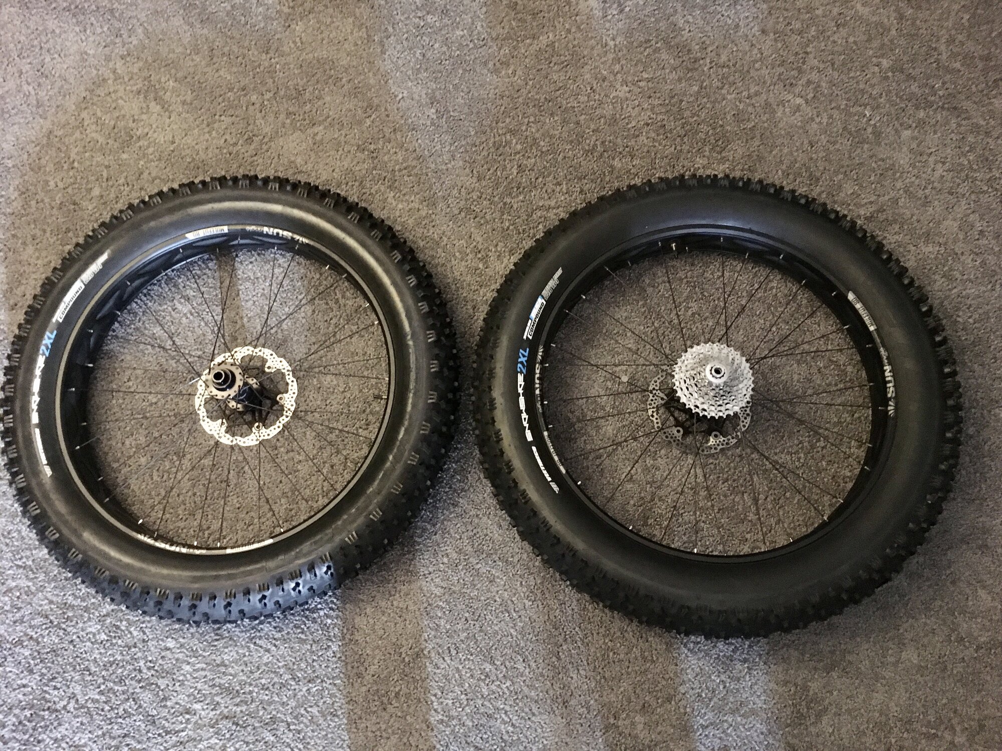

It won’t fit that white Hydra because it’s the regular MTB frame (27.5). Pushkar says they may fit on an 80mm wide wheel but the chain may rub the tire on the last three cogs if your using a cassette. Also the Snowshoe 2XL’s are a taller tire vs a 26X4.8 tire. I’m going to test fit them on a Hydra Fat Frame so I’ll know for sure if they will work or not. My guess is they won‘t fit or the frame clearance will be too little for my liking.5" Fits. wider width will not work .

Should fit, you will need to purchase the fat bike version of the frame.I want a 27.5 x 4 fat tire fitting triangle....
Pushkar will kill me if I switch again lolShould fit, you will need to purchase the fat bike version of the frame.

Actually, Pushkar told me it wouldn't fit. I asked about a week ago. Edit: I mean the 27.5 3.8s.Should fit, you will need to purchase the fat bike version of the frame.
On the Hydra Fat Bike with the 197mm rear spacing it should fit. On the Hydra MTB with the 148mm rear spacing it won’t fit.Actually, Pushkar told me it wouldn't fit. I asked about a week ago. Edit: I mean the 27.5 3.8s.
Rome, there are two versions of the Hydra frame with the only difference being the width of the rear triangle. One is 148mm wide and the other is 197mm wide. You can actually buy the Hydra MTB and then just the Fat Bike rear triangle separate. Then you could swap between the two although it’s not as simple as it sounds.Confusion on the frame. You mean to say ? Triangle for a fat tire?

What about depth? Is the RC the same on the fat tire version?On the Hydra Fat Bike with the 197mm rear spacing it should fit. On the Hydra MTB with the 148mm rear spacing it won’t fit.
That I’m not sure of but someone did post a pic of the Hydra Fat Bike with 27.5 X 3.8 tires. Can’t remember which post it was at the moment.What about depth?
