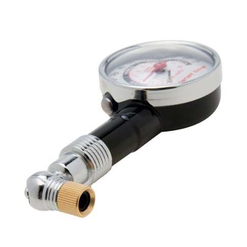

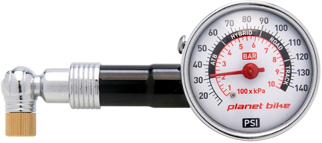

Planet Bike Dial Pressure Gauge
An old school pressure gauge with a quality feel. Soild and heavy for its size. Agrees well with my Topeak electronic gauge to ~1 psi. Best of all, no batteries or recharging needed, ever! Ah, the good ole days (my sons still laugh at my battery free calculator, a Post Versalog slide rule).
Why a pressure gauge for touring? Neither my CO2 inflator nor hand pump have pressure gauges. My preferred fill for a trail side repair is CO2, it's just faster on a hot day. Tubes do lose pressure quite a bit faster with CO2 so our normal practice is to stop at a gas station and refill the tire with good ole air as the first opprotunity. I want to be sure to not over inflate so hence a gauge.
I actually get less air loss with this gauge than with my Topeak electronic. Like an electronic gauge, it holds the pressure reading until you press the reset button. Handy for readings in awkward or low light conditions. I find the white dial very easy to read. The manufacturer states that the dial has a 'crystal lens'. I can't confirm this, but it doesn't feel like plastic.

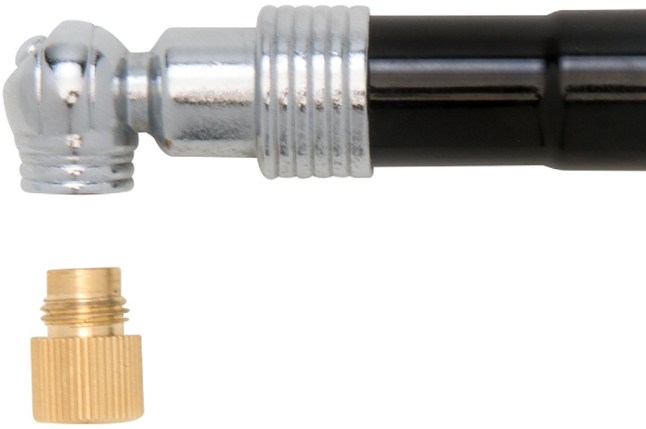

It works with Schrader or Presta valves. A brass threaded adapter is included for Presta valves. The dial gauge goes to 140psi / 10bar.
All in all, a solid addition to out kit.
$18
SKU 1029
Also available as a fat tire bike gauge with a max 15psi range, SKU 1027
