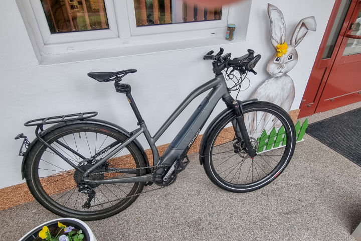

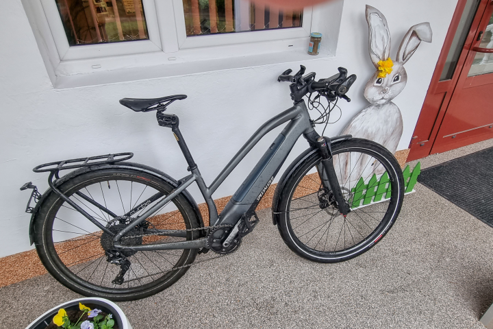

@harr,
Let me only give these answers where I feel competent at.
I use a Vado SL EQ because:
  • It is lightweight and easy to carry. I live upstairs; there have been numerous situations where I was happy to be able to lift and carry Vado SL
  • I enabled me to do even a 91+ mile ride (with 4 Range Extenders) at 13.5 mph average speed or a 72 mi ride at 12.7 mph average speed (1 Range Extender)
  • It is ideal for me to do quite large grocery shopping as for a single person; I stopped using the car, and my shopping is 10 mile round trip. Two panniers and a backpack. I'm sure I carry more than 25 lbs on the return trip from the store, and I weigh 212 lbs now.
  • I often (not always) participate in group rides of my gravel cycling club on the Vado SL. Carry multiple Range Extenders for that.
For more advanced needs, I use my Vado 6.0 (an e-bike similar to American Class 3 Vado 5.0).
Is the SL powerful enough? If I want to keep up with “Lance” on my local trail and he’s doing 22-24mph, am I going to find that difficult even on Turbo?
Maximum torque of Vado SL is only 35 Nm, and the maximum power is only 240 W. To ride at 21 mph, I need the Turbo mode, and it eats the main battery and Range Extenders fast. My typical mode of riding in the gravel club is to apply 80/80% SL assistance, and using multiple Range Extenders on long rides.
Are the non SL bikes just going to be a PITA to move around and get on the bike rack of the car?
Hard to say, as I transport my 58 lb Vado 6.0 not on the bike rack but inside a station-wagon. With the battery removed, of course.
Computer / Mission Control setup that seems really great (i do have an older Wahoo Roam)?
If you own a Wahoo ELEMNT Roam v1, it works perfectly with Specialized e-bikes.
Speaking of.. I see the SL doesn’t come with the handlebar display?! Can I (or LBS) add that one (anyone have a part number so i can evaluate cost?)
Connect your Wahoo ELEMNT Roam v1 and use it as the e-bike display. I own the optional Specialized TCD (wireless) display and it is gathering dust. Specialized e-bikes are LEV ANT+ compatible, so bike GPS computers can be used. Besides, Wahoo is the only known e-bike GPS computer that can understand the SL Range Extender is there.
Are the IGH / Hub bikes still a mess (I’ve ready Dynamic’s thread and a few other “problem” threads on them) or is that just on the Automatiq, and the 3.0IGH / Gazelle with the manual Enviolo’s doing OK?
I cannot answer this question. Why not Vado 4.0 if you need more power? Well, some 58 lbs but the motor is twice as powerful as in Vado SL and you could match your buddy easily on the trail (I primarily ride my Vado 6.0 despite its weight on most of the club rides).
Gazelle has one LBS, about 15 miles away and much smaller in the US market. Specialized has about 4-5 nearby. Should that play a role in the decision, and how should I weight it..
The LBS of a good reputation is the most important with any e-bike. Specialized has one of the best warranties in the market.
I rode my Vado SL for 204 times in 2022. I was only on 48 (but long and fast) rides on Vado 6.0 last year.
I have never taken my Vado SL to ride in real mountains.

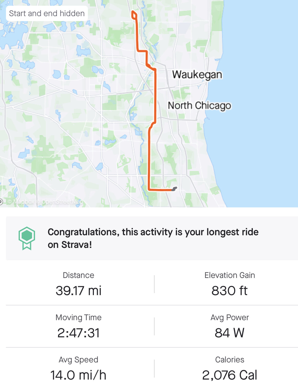

A good example from yesterday: I wanted to do a 45 mile ride with several planned attractions on the trip, and it was guaranteed it would be raining. Even with good rainproof clothes, riding in the rain is no fun. It was clear to me I would select the Vado for less pedalling effort and higher cruising speed. However, I was controlling myself and decided I would do the whole ride in true ECO mode. Guess what. I could complete the ride on a single battery. The battery consumption per km and the average speed were similar to what I usually achieve on Vado SL with higher assistance! Only the ride felt a pleasure, and I returned from the ride fresh. Were it a sunny, dry and warmer day, it could be a Vado SL ride!

From my Vado 6.0 ride of yesterday. 34 F, icy rainfall all the way, strong headwind on the outbound leg of the trip, 27.7 miles. Notice numerous improvements for a proper distribution of my body weight between the butt and arms, more aero position, and especially a narrow sporty Specialized saddle I bought on purpose ;) (I rode for 45 miles the day before on the same e-bike, a single battery ride).
