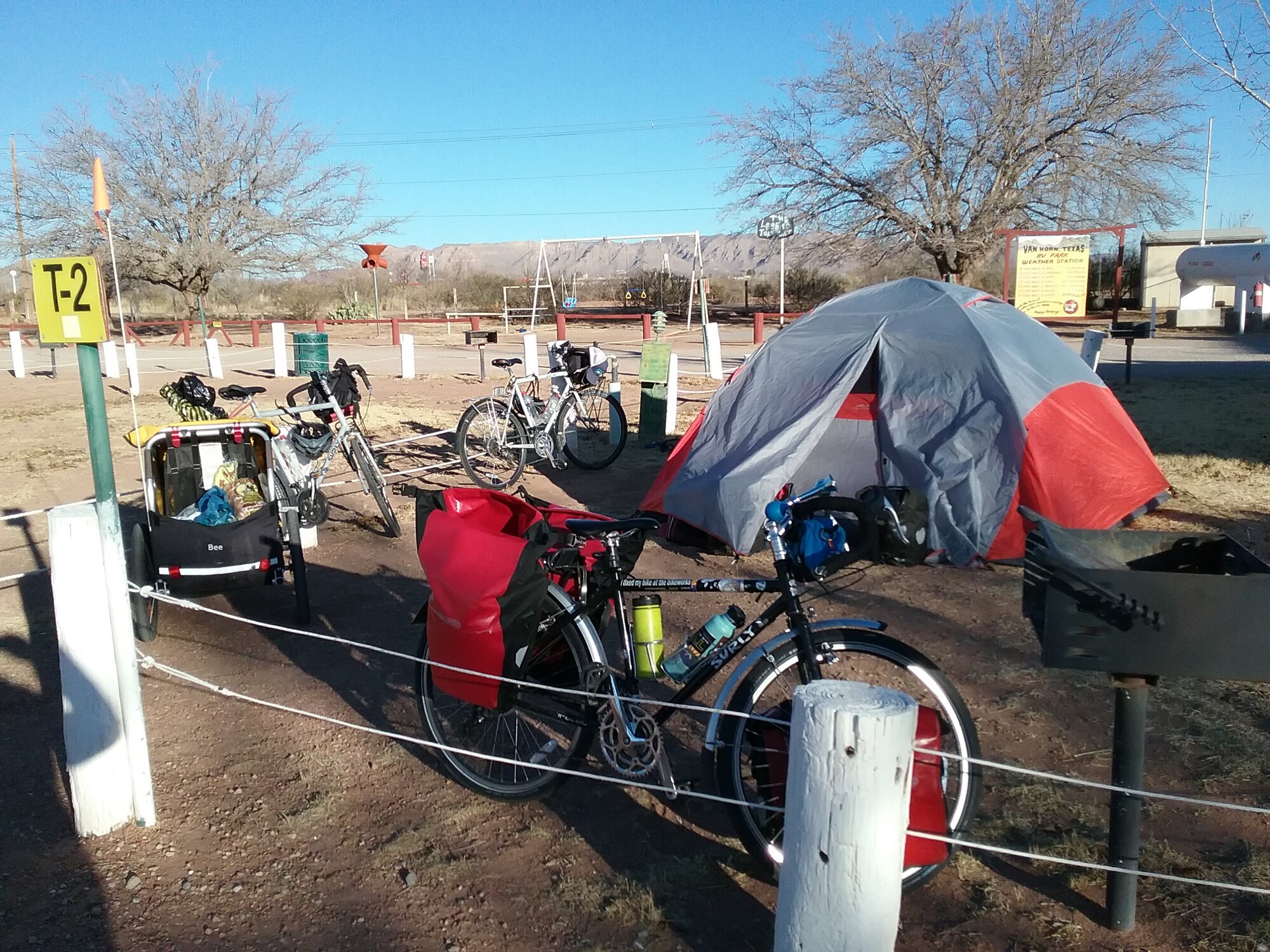

I camped by this family in Texas. They started pedaling in Portland. No motors, no support car, 2 adults, a 10 year old, and a toddler in the trailer... not for me, but some people can do that.
They seemed like nice young folks, but I hate them anyway. 😄
