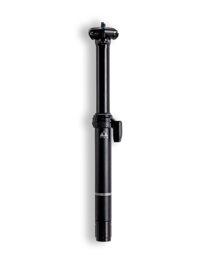

The third option is to buy and install a dropper post. The MTB dropper post lets you slide the saddle down by pushing a lever on the handlebars and simultaneously pushing the saddle down. It is very easy to mount (and especially dismount) the bike with the dropper post. Once you have mounted the bike with the saddle down, you just stand on the pedals to make the bike move, press the lever and the saddle slides up to the original position. Before any stop, you activate the lever and press the saddle down with your body. It lets you patiently wait at the signals with both feet on the ground and it also makes dismounting easy and elegant as there is no saddle/post in the way of your leg.
Driven by an advice of a Forum user, I have ordered a suspended dropper post from PNW, the only in its kind. (A regular dropper post has no suspension). If you order any dropper post, pay attention to three factors:
  1. The diameter of your original seatpost. The Vado seatpost diameter is 30.9 mm.
  2. The cable routing shall be external. The dropper seat post cable needs to run along the tube of the frame on the outside. (The internal cable would require disassembling the bike! Don't!)
  3. Choose such a lever that can be easily mounted on your handlebars.
If you are not mechanically apt, leave the setup to your LBS.
That's what I ordered, it is only an example:
Here is how the Puget 2x lever looks like:
The link to the web-page:

By the way, the dropper post you bought appears to be air-filled. Does that mean that you have to have a high-pressure MTB shock pump with a gauge and all that?
I presume so. The suspension dropper post is expected to be delivered the coming Monday. I'm going straight to the LBS with the Vado and the delivery, and the mechanic will do everything necessary. I will report.
