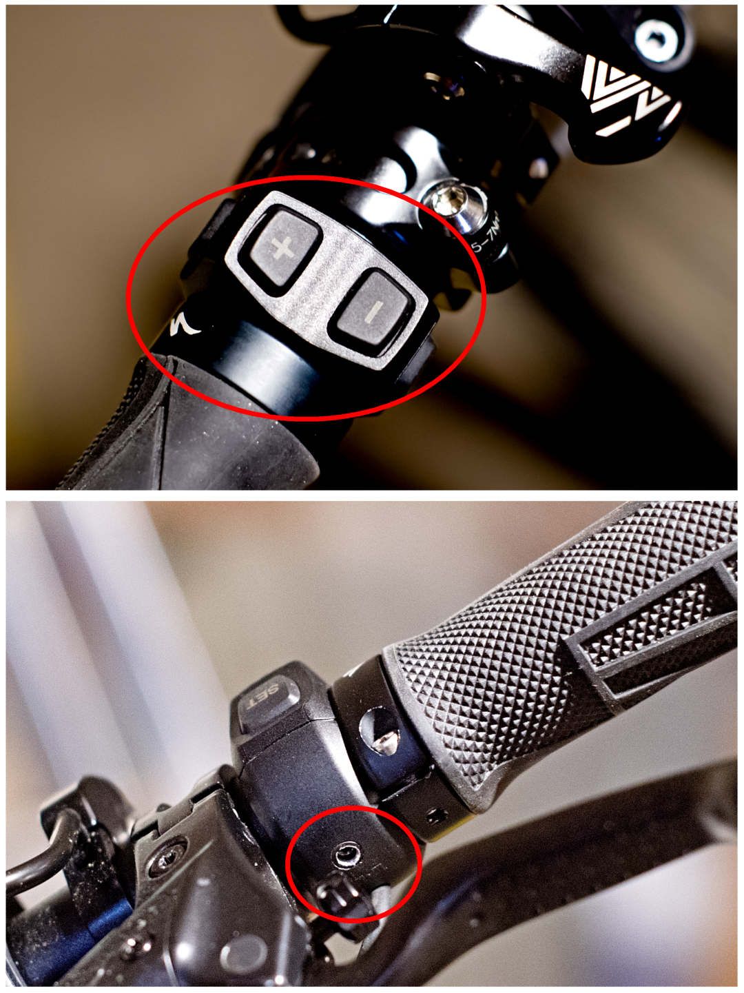

Anyone knows what wrench is needed to remove this from the handlebars? I can't see well.
Can't tell exactly But those are usually Hex head Wrenches - H5 or H6 in size Or what we call Allen Keys in The USA You can find Socket sets or I have one from Trek That has a 4,5 and 6 all together in a T-handle : If you're going to work on the Bike I'd spend the $20 and buy a Set H3 -H12 They do come Standard or Metric. But I haven't run into a Bike yet that didn't use the Metric Sizes : Definitely hard to strip : But Imossible to get off if you do :
Looks like this needs a T8 'star' bit. The actual fastener faces are recessed into the fastener so I had to use trial and error to get a bit that fit well. The bit is pretty small so I was careful not to over tighten.
It could be Either torx or Hex head : I said Hex because that's what My Generic Specialized has . So do My Treks
I wasn't able to find a metric hex head that would fit. The T8 bit fit well.
The Vado has a mix of hex and torx fasteners. Doesn't seem to be a rhyme or reason to the mix. I'm guessing it's related to component suppliers.
Thank you very much @Sierratim! Your advice was very good. Among other things, I got me the T8 wrench and indeed I was able to unscrew and rotate the Vado remote into the appropriate position. Now I'm ready to change my handlebars to Baramind BAM Trek suspension ones! Provided the Red-Motion the maker who are in France are currently in operation. Their handlebars disappeared from Amazon.
