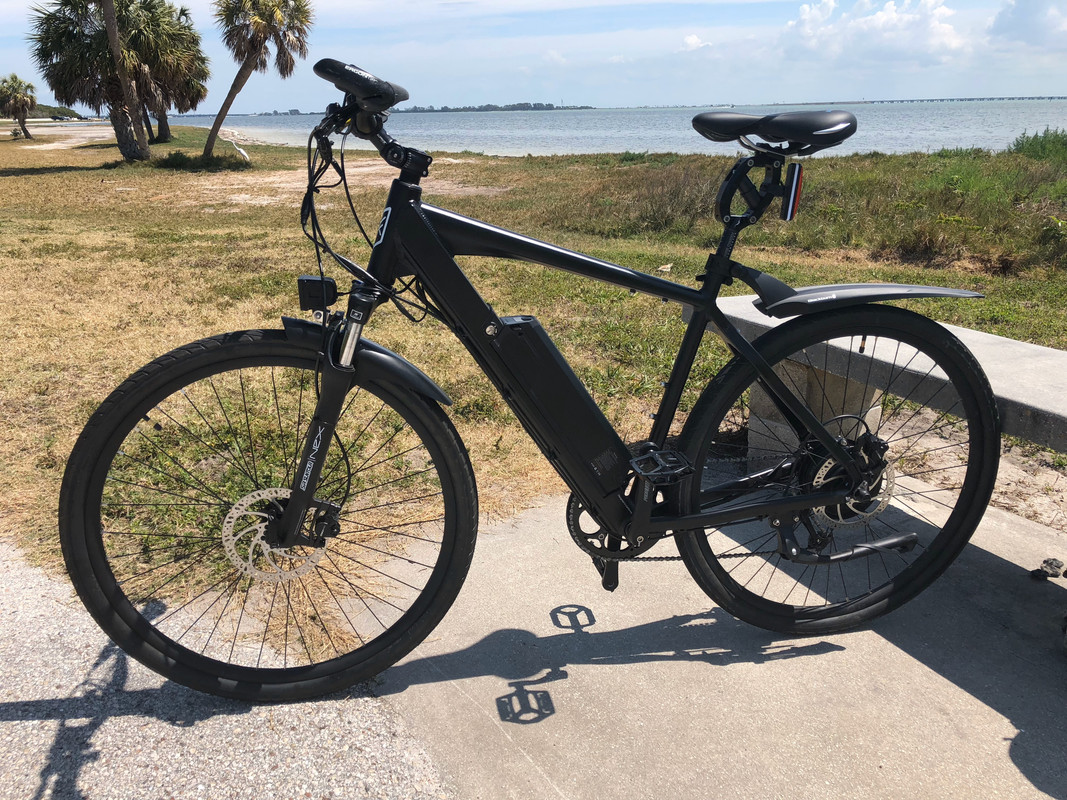

The Juiced bikes are cheaply made. They have terrible welds. The waves of the welds are visible. I have a friend with one. He's already had the throttle replaced and issues with electrical climbing up hills. The 52V 19.2 Ah battery is overrated. I get better range because I can often use no assist to ride like a regular bike where he couldn't because the bike with motor and battery + fat tires 4inch = to heavy. Riding up steep hills the battery depletes quickly. They're are not high end bikes. Also, they don't fall into any ebike legal class because the bike has a throttle yet is capable of speeds of over 28mph. The Turbo Vado 5.0 is far more polished with respect to components and features. Also, it's a true Class 3 legal in U.S. I rode the bike it felt like I was on a tank. I was happy to get back on my own bike which feels like a regular bike although it isn't. You get what you pay for. Also, they don't have the type of warranty and support that Specialize has. No comparison.
I know what you mean. There's a shop in my area that went to e-bikes early and carries mostly bikes like you describe. The owner is a bit of a "character", a self-taught guy who knows a lot but thinks that he knows everything. For example, he won't sell a mid-motor bike and claims that a hub motor with throttle is "the only way to go". I rented such a bike in Tucson last year and would never own one that acted like that! And, as you point out, he's selling bikes that will probably hit 40mph which is not even close to legal anywhere around here while being ridden as a "bicycle" and should probably be classified as "motor scooters" that have strict registration and safety requirements.
I have to chime in on a positive note for Juiced. My first electric was a CCS, and it's what got me addicted. I rode the hell out of it 100-150 miles per week for 3,000 miles and never had a problem.
Sure, it's not bike shop/big brand quality, but it's also not $5,150 like my Vado. I paid $1799 delivered I believe.
It was a great first bike and makes for an awesome inexpensive commuter.
