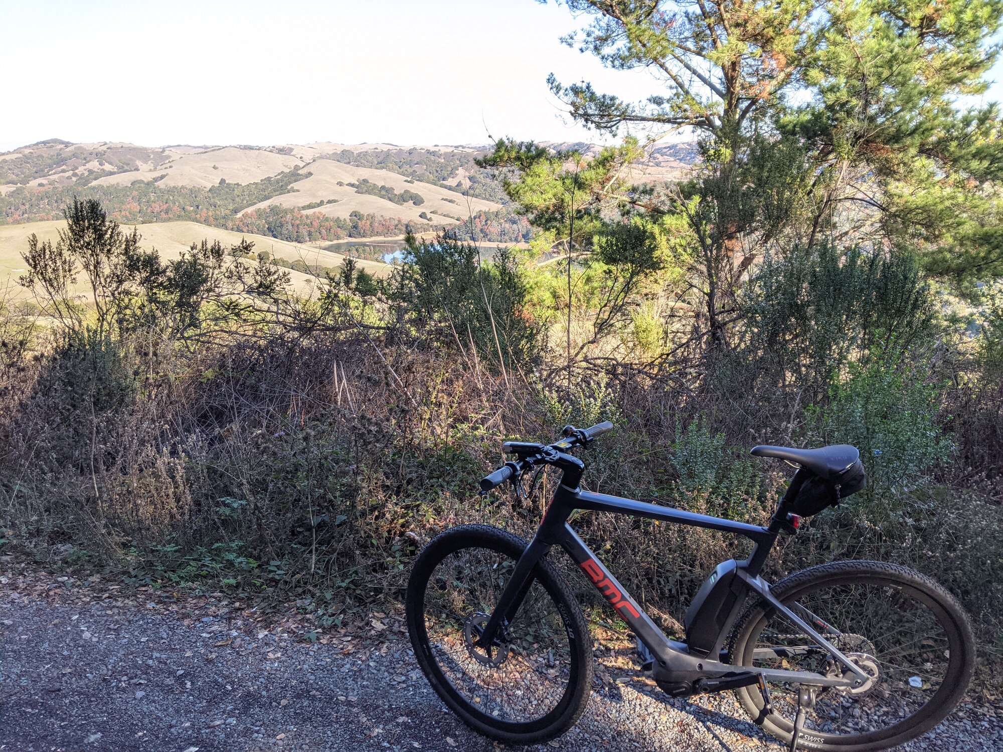

Below is a shot from today. In the background you see the San Pablo Reservoir in Contra Costa County, California.
