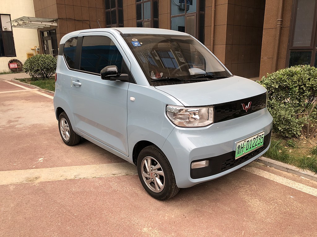

Seems like this comes down to EV packs, so maybe there is some time before the flood shows up. One thing is certain, the tendency for large and high performance cars and especially trucks/SUV's means bigger packs. In China young people drive a small EV with a 10 kwh pack. Here it is 10x that. Just a lot more to recycle. Nothing at that level can be repurposed.
