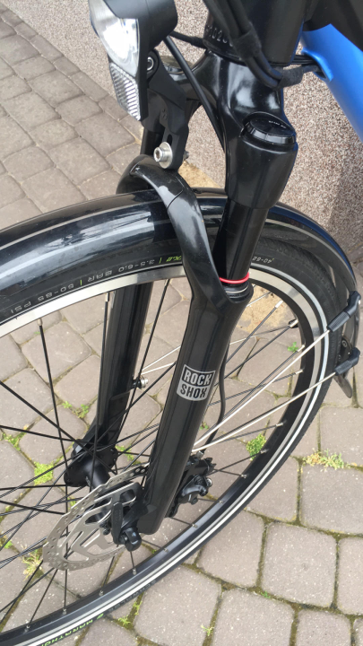

Cool, fenders! I had to loose my fenders when I moved up to 60mm urban tread. Not enough clearance. Does the RockShox have fender studs/bolts?
Yes, it has. The point is, the crappy Suntour NEX fork broke on that e-bike. My brother who currently rides that bike was unhappy. He asked me to do some market research with the motto "Don't let your friends buy Suntour forks" ;) He was very critical about my choices; we have eliminated the RST forks from the equation too. He demanded it should be an air fork (65 mm travel max), it should be good for the 9 x 100 mm QR axle, it should have fender bosses and it should not have the V-brake attachment points. We found the Rock Shox Paragon Gold RL the only remaining, available and affordable option. The price was EUR 169 (it was around USD 200 with the shipment cost).
My brother was enchanted with the sus fork as it met all his criteria. It even came inflated to 100 psi, exactly for his own weight!
