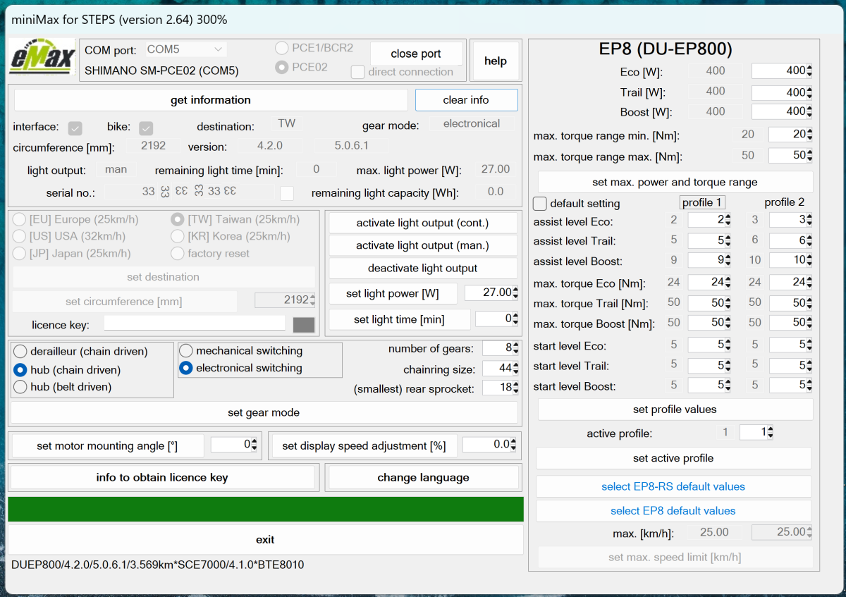

1. Download eMax miniMax or MobileApp (Bluetooth) software to talk to your motor. Connect, and send a screenshot to eMax (Markus) to evaluate how to proceed.
Of note: TW region specifically is locked and causes trouble. Markus says motors from the other regions wouldn't require the extra steps I'm documenting in this post. Shimano USA has already been in here to modify my wheel circumference and to activate my "electronical switching." Note also this motor is limited to 400 watts. This is the screenshot I sent to eMax before paying for a license.

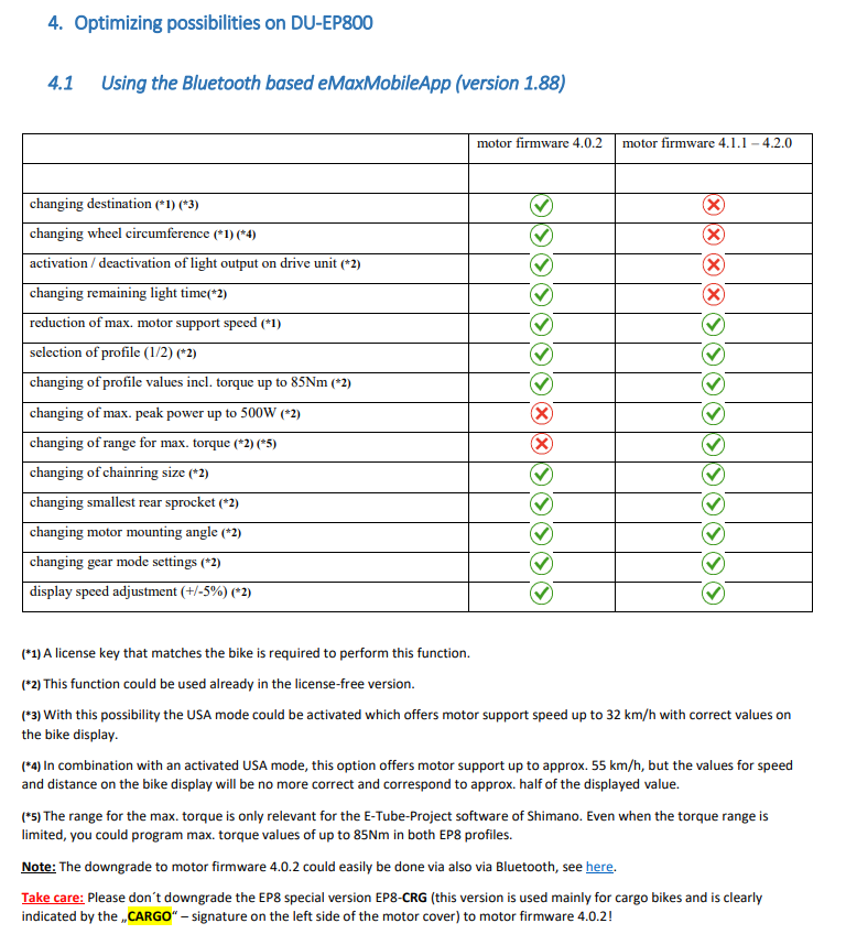

2. Get a Shimano PCE-02 cable. Often this isn't necessary and can be done over Bluetooth, but in my case it was necessary. Great, I already have the cable.
eMax has documentation what changes are possible depending on what version firmware the motor has installed, and what is Bluetooth accessible vs. requires PCE.

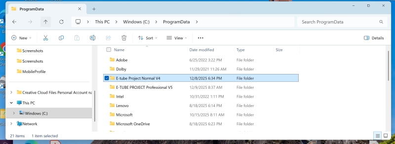

3. Download E-Tube version 4 (old) software from the eMax site; install it
I assume the newer version of E-Tube perform cryptographic verification of firmware before allowing it to be installed, so this older version is used. eMax notes that I don't have to uninstall the current v5 E-Tubes software, and sure enough, it installed to its own directory.

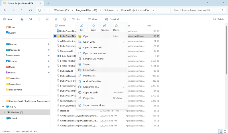

4. Download a E-Tube V4 "companion file" from the eMax site and install it in the V4 directory
I moved this Zip file right into the E-Tube Project directory, right-clicked, and extracted it there (highlighted files). I don't know what this file does

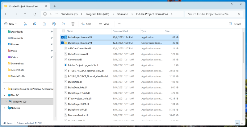

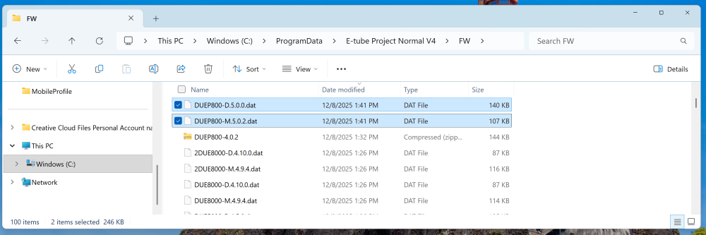

5. Download old 4.0.2 firmware for the EP8 motor from eMax and install it

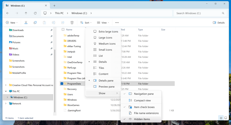

For this one, it needs to be installed in a hidden Firmware directory. To make hidden directories visible, from your Windows file folder, click View, then Show > then Hidden Items
Just like the step before, I dropped the Zipped files here and extracted them.
After extraction, the files are named "D.4.0.0" (or whatever), and need to be renamed to a higher version ex. "D.5.0.0" to spoof the E-Tubes software into thinking it's the latest and greatest. Just right-click and select "Rename" from the dropdown to do this.

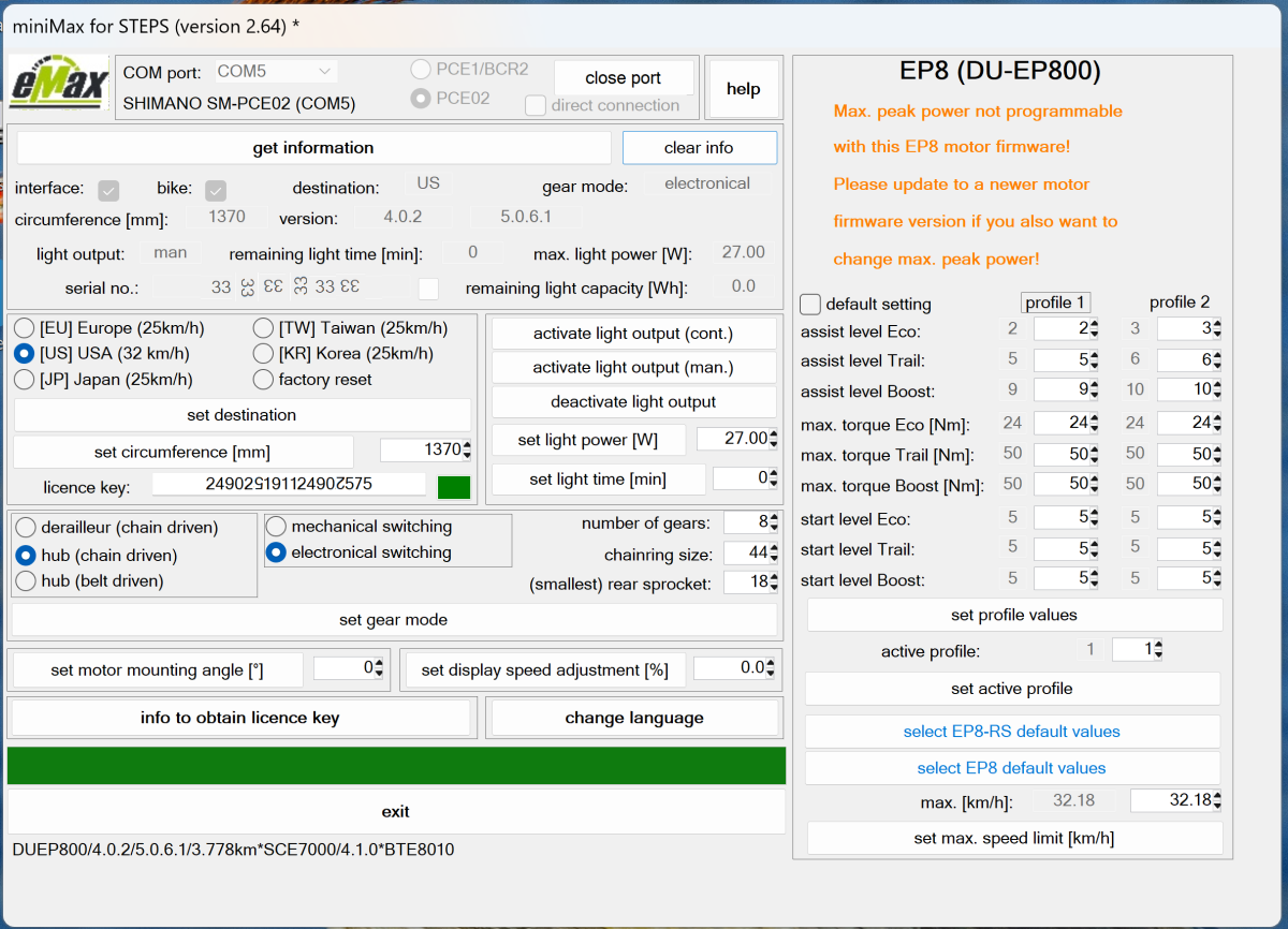

6. That's it! Open Version 4 of E-Tube and connect to your motor. eMax instructions suggest to connect directly to the motor, but I connected to a vacant port on my head unit and this all worked fine. E-Tube will instantly see that there is an update available and after you select it, it will run the update in about one minute.
You'll then disconnect E-Tube, and reconnect the eMax miniMax app. You'll find that the region and wheel size are no longer greyed-out, meaning they're adjustable.

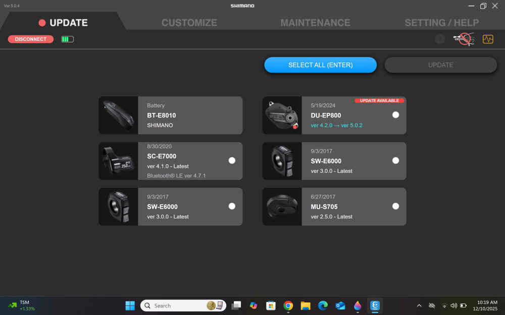

The 400W limit is still in effect. That will revert to 500W after you reconnect using the V5 (current version) of Shimano E-Tube, and update the motor back to the current software version (currently 4.2.0).

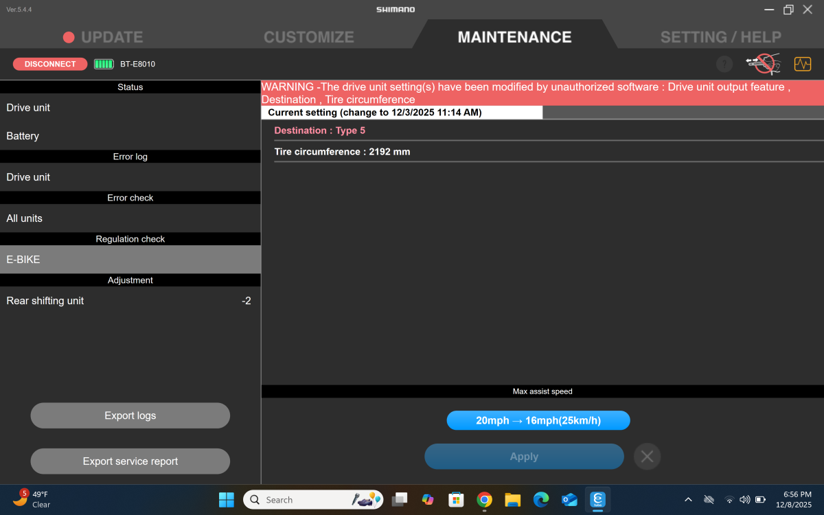

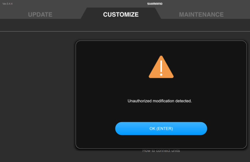

Upon re-entering E-Tubes V5 I received an "unauthorized modification" notification. The system prompted me to revert back to the previous configuration. Refuse this request. Proceed forward and perform the firmware update. Updating the firmware will eliminate this message from appearing again.
What will be persistent is a warning on the Maintenance tab. There's really no issue with this, although Markus told me they have something that can be done to eliminate it. I don't want to bother as it won't revert the motor back to the previous configuration, and Shimano is never going to have this motor for warranty work since it's a gray market purchase.
