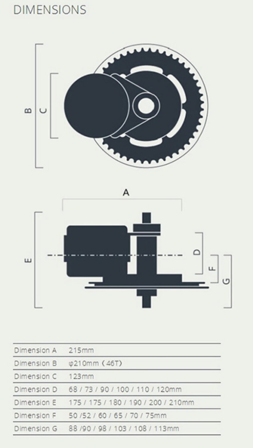

I used this to determine chain line.
D is Bottom Bracket option of your motor (68mm is typical)
F is chain line from center of Bottom Bracket
