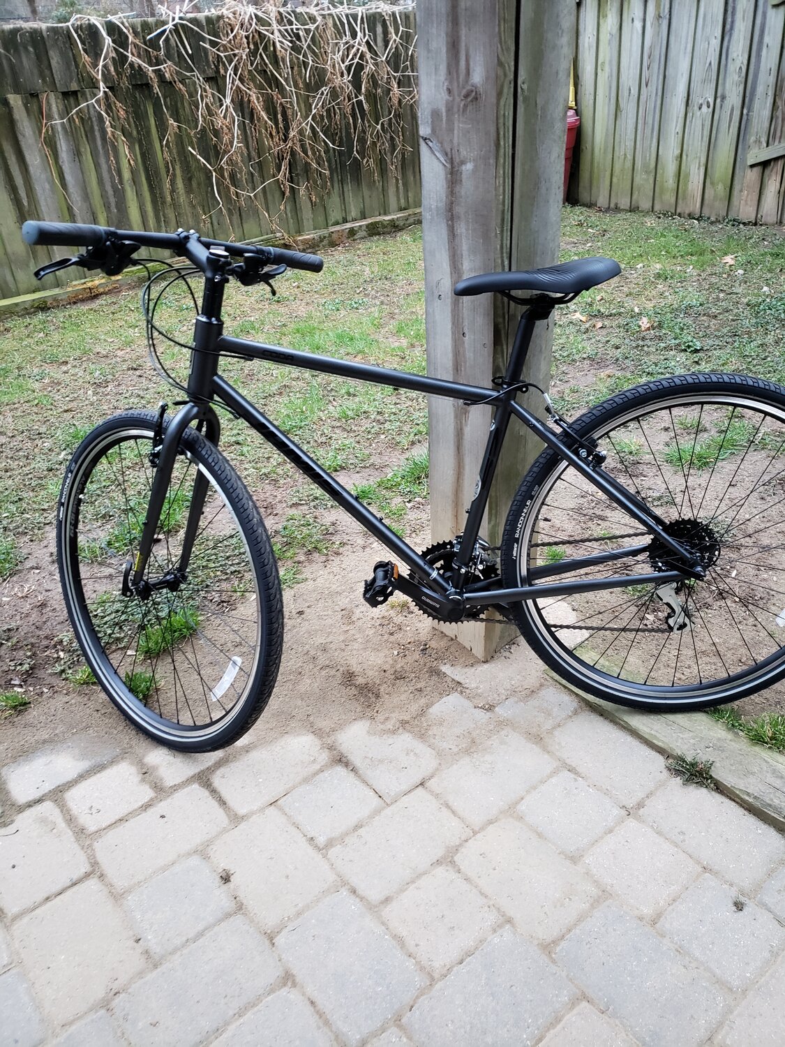

So I picked up this Jamis Coda S2 and rode it around and it is light and almost buttery smooth. I have been inspired by @PedalUma and really want the stealth build with the 36v water bottle battery. One thing I am pondering is weather to do the OSF or not.
I will be commuting with this bike and also wondering about how the kit will handle the temps of year round riding? How hot is too hot? Or too cold?
My plan is to get a second battery for longer rides and also thinking of getting a second bike and putting a TSDZ2 on that one as well for when I have to take the bike to the shop so I am not off the road for any amount of time.
I will also have to get used to riding this kit as I have been using a hub motor bike for the past 5700 mile and have become accustomed to using the throttle from a stop and ghost pedaling. Should I add a throttle?
Any tips and thoughts appreciated!

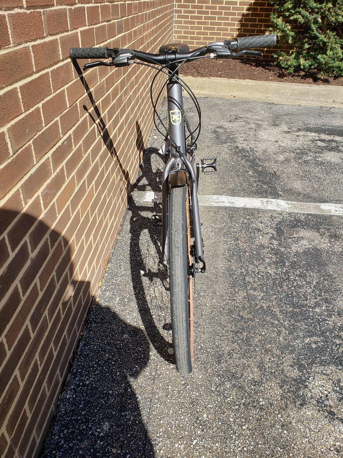

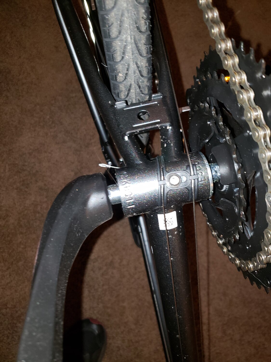

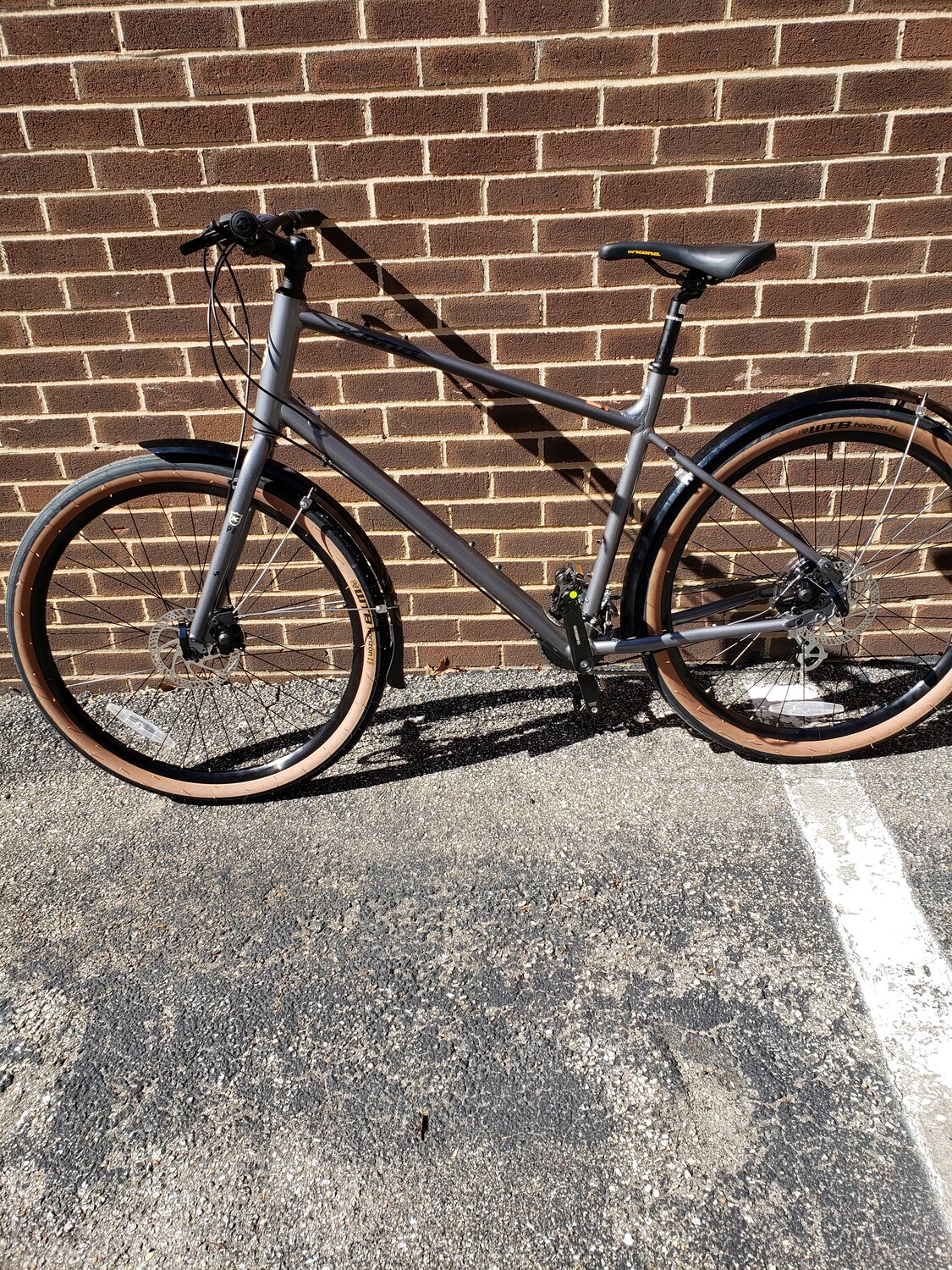

Well I ended going with a different bike and kit! No turning back know because the kit is on the way (Bbso2) and I am putting it on one of my favorite bikes the Kona Dew. I figured I wanted at least mechanical disk brakes and I plan on upgrading the rotors size and adding Juin tech calipers as I already have this setup on another bike and I like it.
I will mostly be commuting so I am wondering about the chainring choice I should make because I think the stock ring looks like crap and would like one with a narrow/wide profile. Are Lekkie's the thing to get or are they just for chainline issues ?

Very nice quality bling rings and narrow-wide chainrings can be helpful in preventing chain drops. In 6 years of customer support I can count product issues on 2 fingers.
So I could use one even without chain line issues? I would not want to order one if I can't use it lol. I got the kit from JohnnyNerdout and it will come with eighter 44 or 46t depending on inventory. I am guessing 46 or 48 for the riding I will be doing.
I’d ask your kit supplier.
Jimmy, maybe I'm not following your question properly, but I don't see any way of predicting chain line issues for sure prior to the actual install of the motor.
