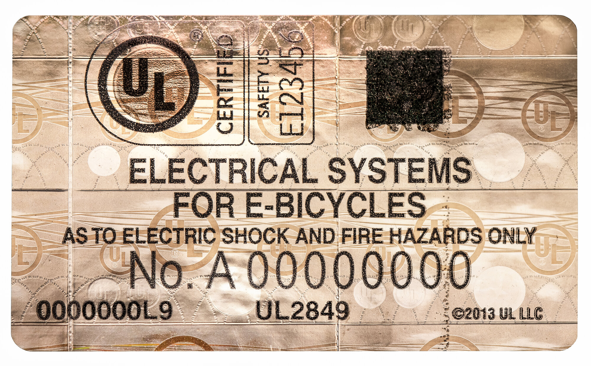

My name is Ibrahim Jilani, and I'm the Consumer Technology Director at UL Solutions. I've been at ULS for 18 years and the son of a electric lighting manufacturer who has been ULS certified for over 40 years. I would like to help the community of e-Bike riders, makers, and retailers find better ways to look for UL Solutions Certified e-Bikes, e-Scooters, and light EV batteries.
Generally speaking, there is a public database UL Solutions has to find certified products, it's called UL ProductIQ and accessible at www.ul.com/database.
The way the certified products appear is based on the "Applicant", e.g. the company who has applied to be ULS Certified. If that company chooses to only show their company name as the "Listee", then that is what shows up. If the Applicant chooses to show the bicycle manufacturers who are receiving their electrical system as Listees, then multiple bicycle companies would show up in UL Solutions database.
I encourage all UL Solutions Applicants to include their specific customers that will use their electrical system, so that more of the e-bike brands who use ULS 2849 certified systems will show up in the public database. At the end of the day, it's the Applicant's decision on who shows up as the Listee(s) on the UL Solutions database. For any UL Applicant seeking to add Multiple Listee, here is a quick overview of the process: https://www.ul.com/services/multiple-listing-service-ul-certified-products.
I request this group of enthusiasts to discuss with their e-Bike brands that they would like to see more "Applicants" of ULS Certification to show "Alternate Listee" or "Multiple Listees" on the UL Solutions database. This way the community will have much more transparency on the models that are ULS Certified and associated to the e-Bike brands. Thank you very much for your support and please continue to ride safe, and ride ULS safety certified e-mobility.

However keep in mind that the e-Bike electrical system certified to UL 2849 is what riders really be looking for. UL Solutions require the UL Mark holographic label to prevent counterfeit of the system. I have shared that certification label in my previous post.
