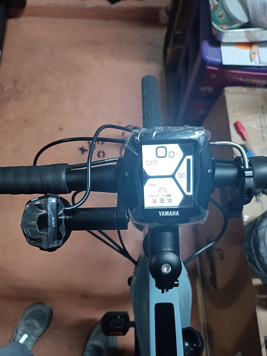

I know this is an older thread, but for those still interested, I have successfully swapped my Display A for Display C on my Wabash RT. It was a straightforward swap. Just plug and play.
I can also confirm that I swapped my original display A that came with my crosscore rc with the display C and it works great 👍
