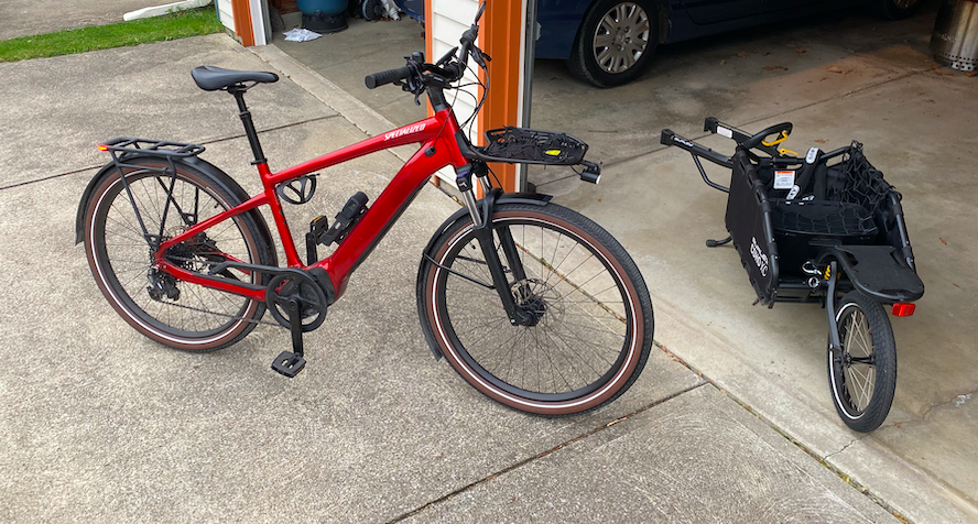

Mine arrived the other day. I took off the included plate with the intention of using a basket instead.
Installation was going well up until I discovered that the headlight cable is a few inches too short to reach to the new mounting position out front. I tried looking for more slack behind the battery with no luck, so I'll be taking it to my LBS to see if they can help me out.
Aside from the cable length issue, I was pleased to discover that the rack has a nice cable routing solution on the underside and they include screws with special washers designed to hold the cable tucked neatly in a guide channel.

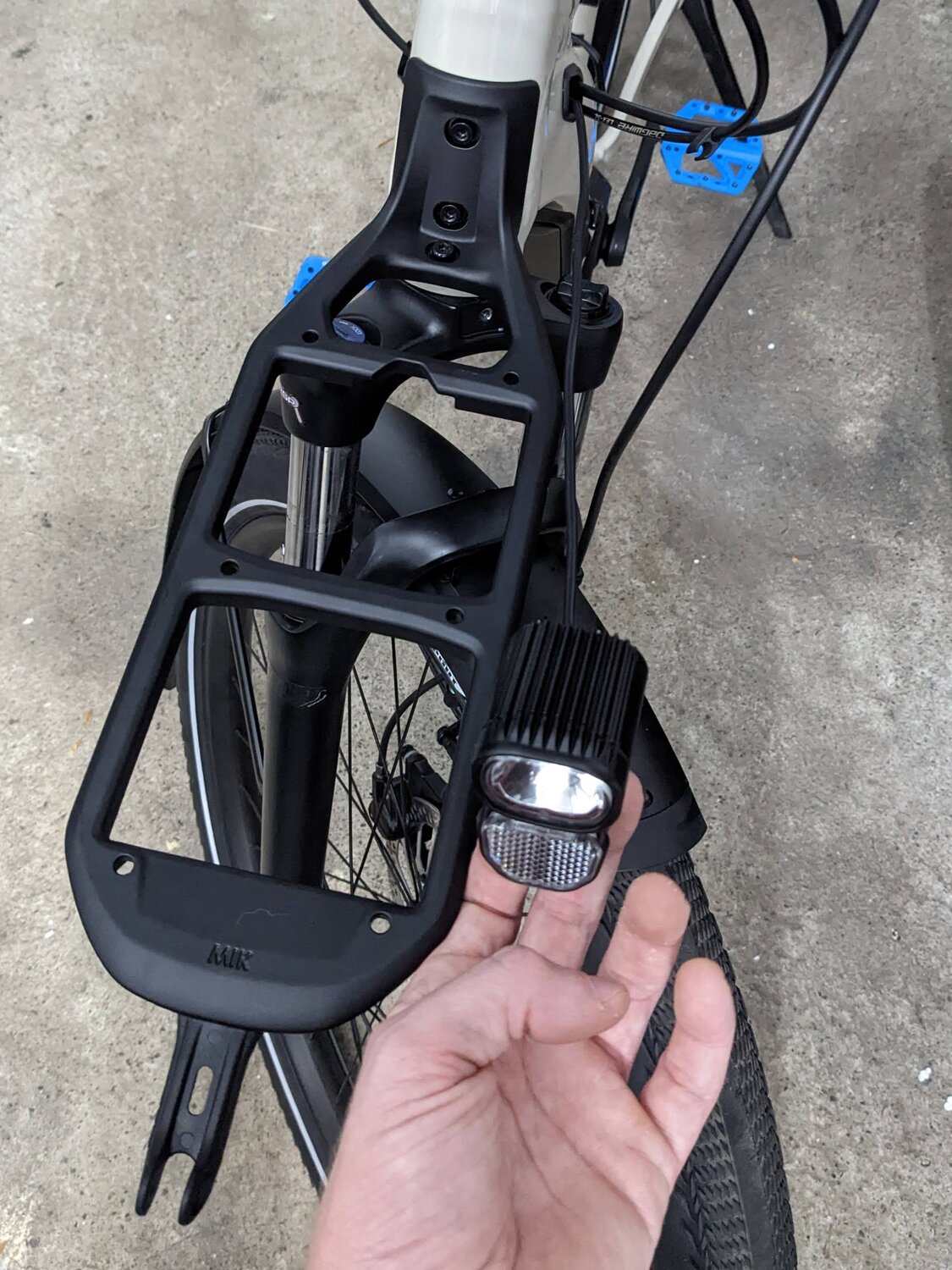

I received the front rack with the adventure plate today. Indeed, the front light cable is too short by a good 4 inches so I cut the cable and spliced an extension cable in.
I decided to mount my front light upside down so that it wouldn't interfere with cargo that could protrude beyond the front of the adventure plate.

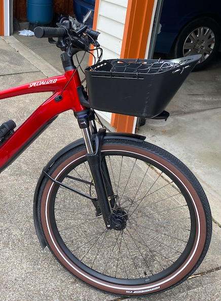

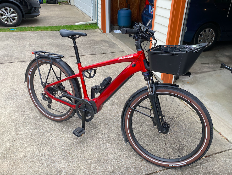

I took the adventure plate off and tried the basket. It will only fit backward. I even tried switching the mik adapter but the back part of the basket interferes with the handlebars. The basket is only going to work installed backward as is shown in my photo.
All in all, it is nice I just wish I could have the basket installed the right way.

Before I cut my headlight wire to extend it... I did use a rubber band to attach the headlight to the handlebars. Which did work. Other than that you have to cut and splice in wire to extend the headlight.

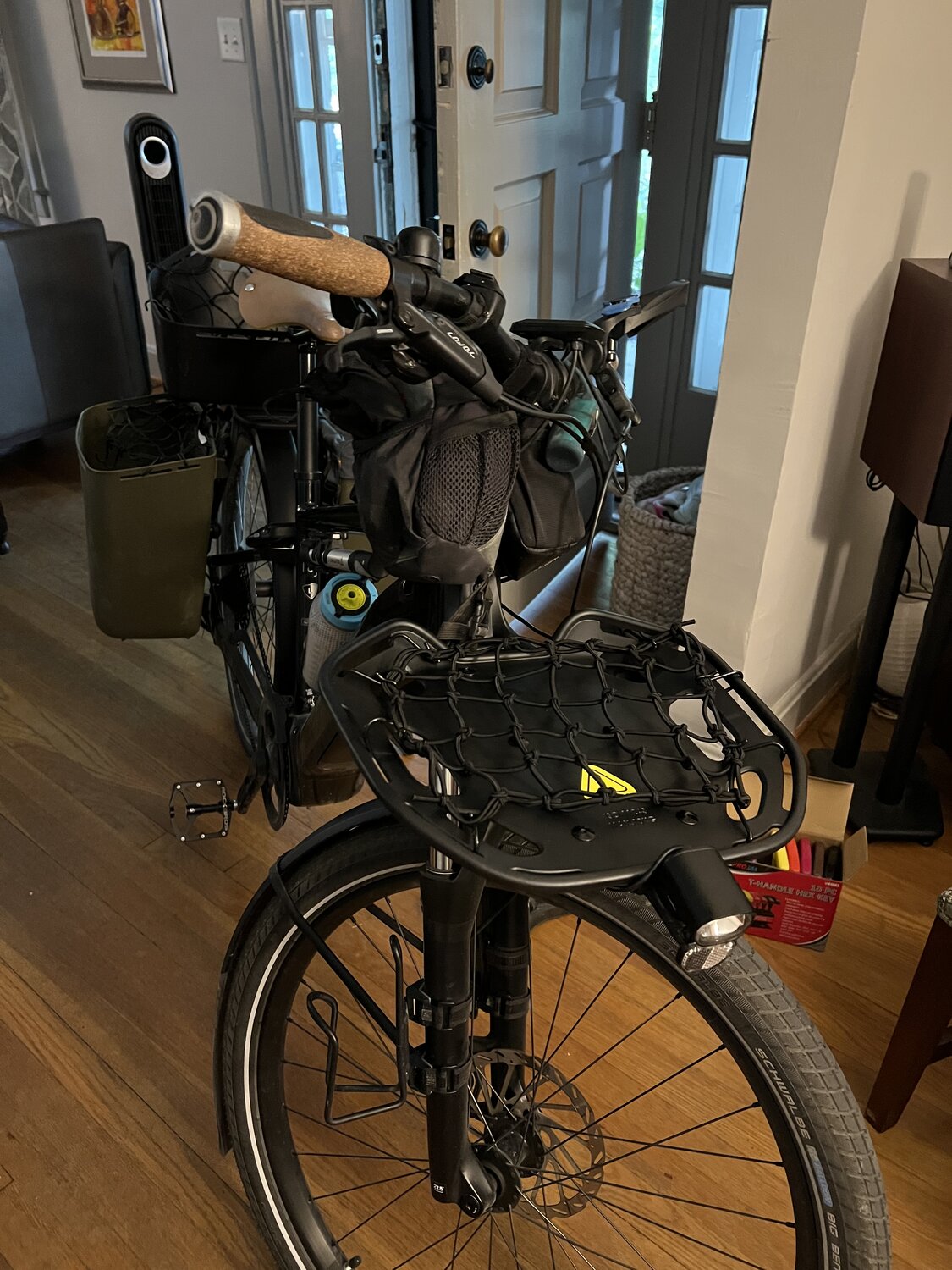

Mounted the front rack & tray yesterday. I had plenty of cable on my headlight stashed in the frame. Fairly easy to install but definitely want to use the included washers or you’ll be screwing into the steerer tube. Love the setup. The more I can carry on the bike makes for less excuses for taking the car.

Great to hear you had enough cable.
