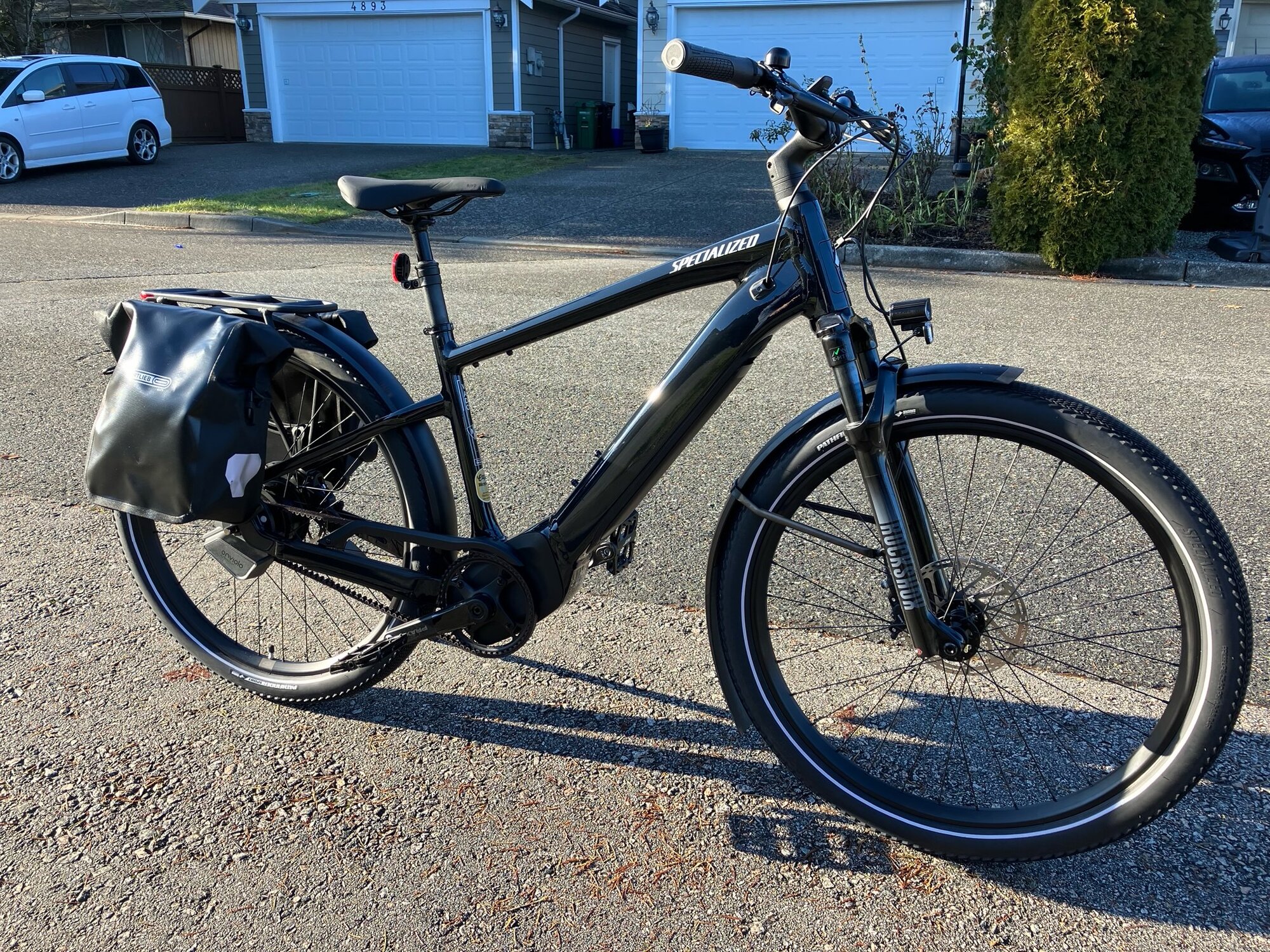

I've been dealing with an intermittent 'creak' from the bottom bracket of my Turbo Vado 5.0 with IGH.
My local Specialized dealer got approval from Specialized head office to perform the warranty work. Why they needed 'approval' to work on a bike that is clearly under warranty is beyond me?
Regardless, I brought my bike to their shop, along with a written report describing when the creak appears (After riding for at least 10-minutes).
Today the bike shop calls me to tell me they can't hear the creaking. I asked them if they rode the bike for a while before bearing down on the crank. Nope!!!!
They then asked me why I modified the rear wheel by adding another motor to the hub?
WHAT?!!!!!
For the life of me I had no idea what they were talking about. And then I realized they had never seen a Specialized bike with a IGH with Gates belt drive.
Oh crap!!!! I'm dealing with an authorized Specialized bike shop that has never seen a Specialized bike equipped with an IGH.
I am so HOOPED!!

Following a few days with radio-silence from the bike shop, I called them today for a progress report.
The shop owner told me they rode the bike but didn't hear any creaking and asked if I could pass by to demonstrate the problem.
Fine.... so I just returned from the shop, and satisfactorily demonstrated the 'creaking'.
The shop owner agreed, apologized, then agreed to replace the motor with a spare he had in stock.
Let's hope this resolves the annoying creaking!!!
