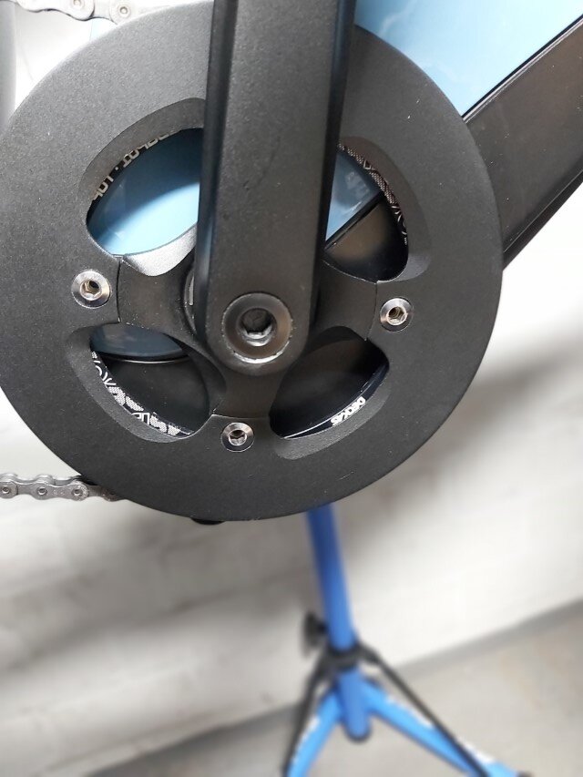

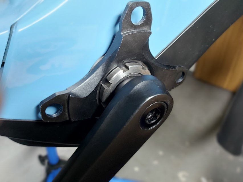

Maybe for those interesting own a Turbo Vado 3 from end of 2020 new model year 2021 with Alivio 9-speed. It seems Specialized used another spider for this model compared to older Vado 3 as well as the Vado 4 and 5. The chainring guard and chainring are all together mounted with the 4 chainring bolts. So there are no additional holes and screws for the chainring guard. So it was a straight one to one replacement of the chainring.
