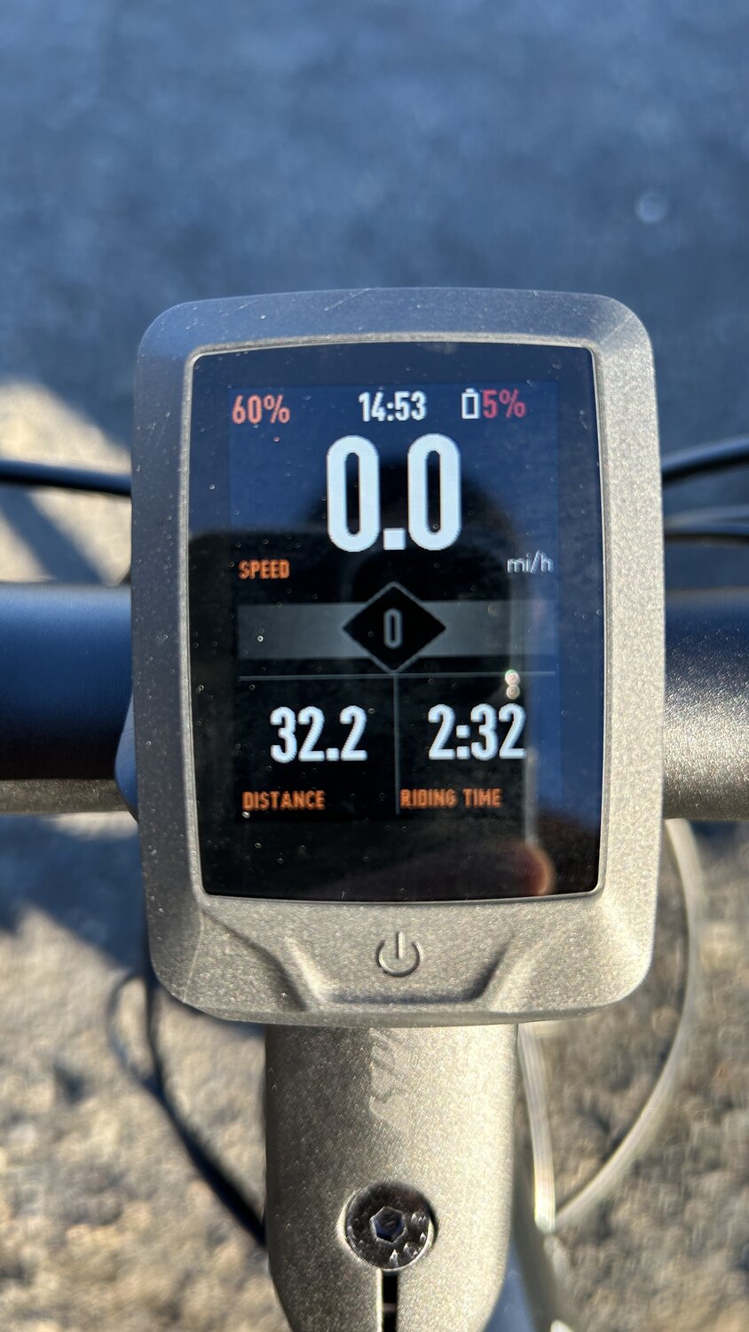

I had range anxiety today. The battery lasted only about 32 miles... (Yes, it was charged to 100%).

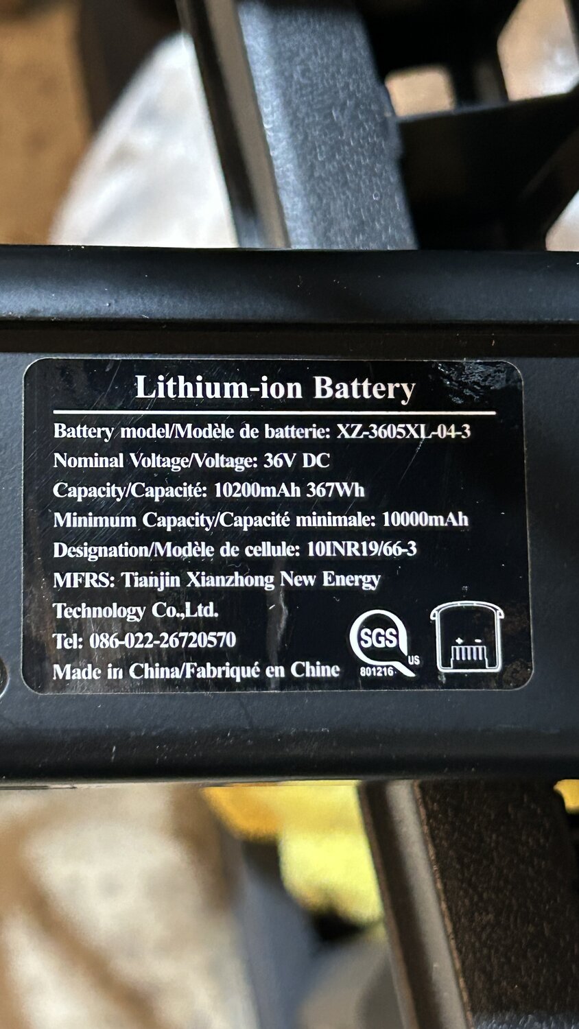

This is disappointing. My other mid motor Walmart bike (Hyper) has 367WH battery (see attached picture) can get around 35 miles of range under same conditions! with Specialized 530WH I would expect at least 40 miles of range.

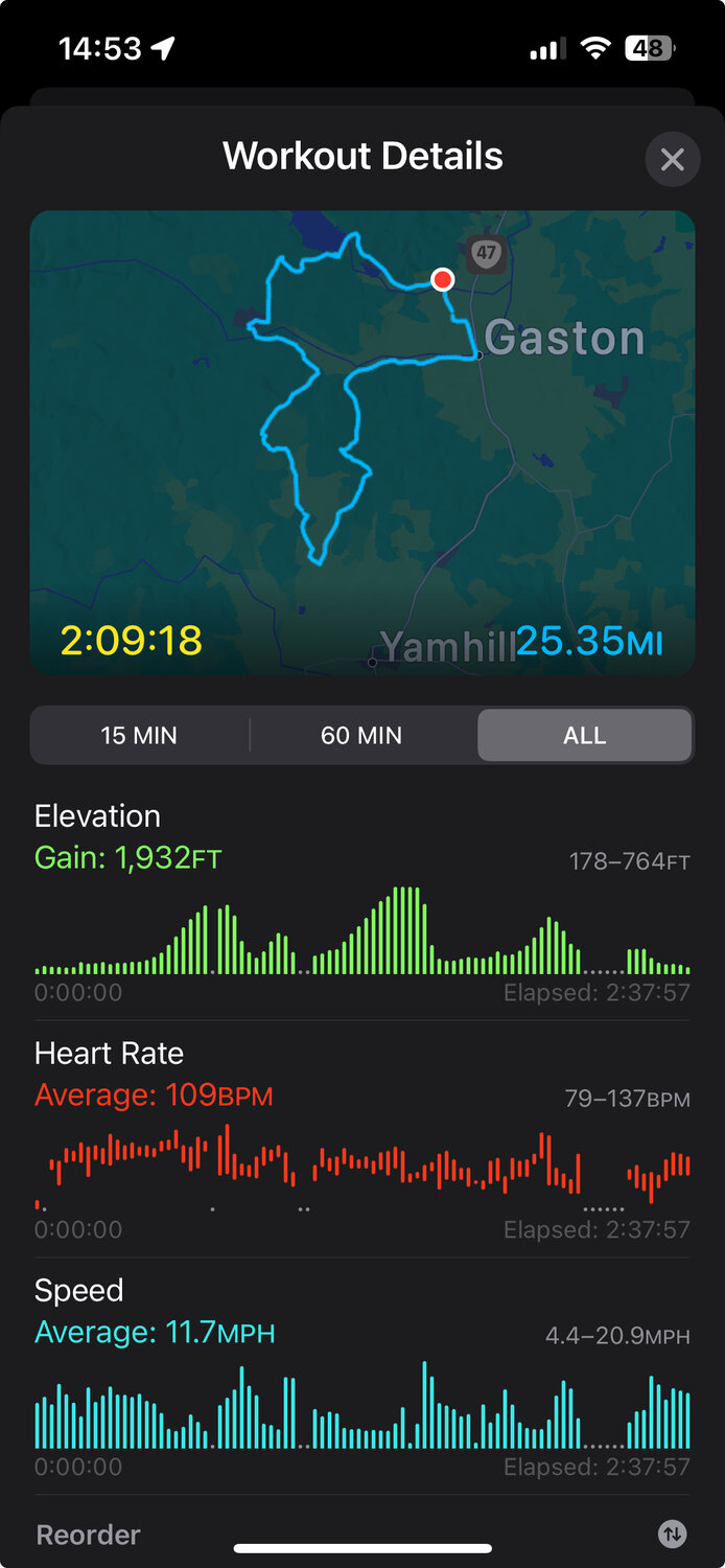

using Garmin or Strava to look into the data of the ride? Curious to see.

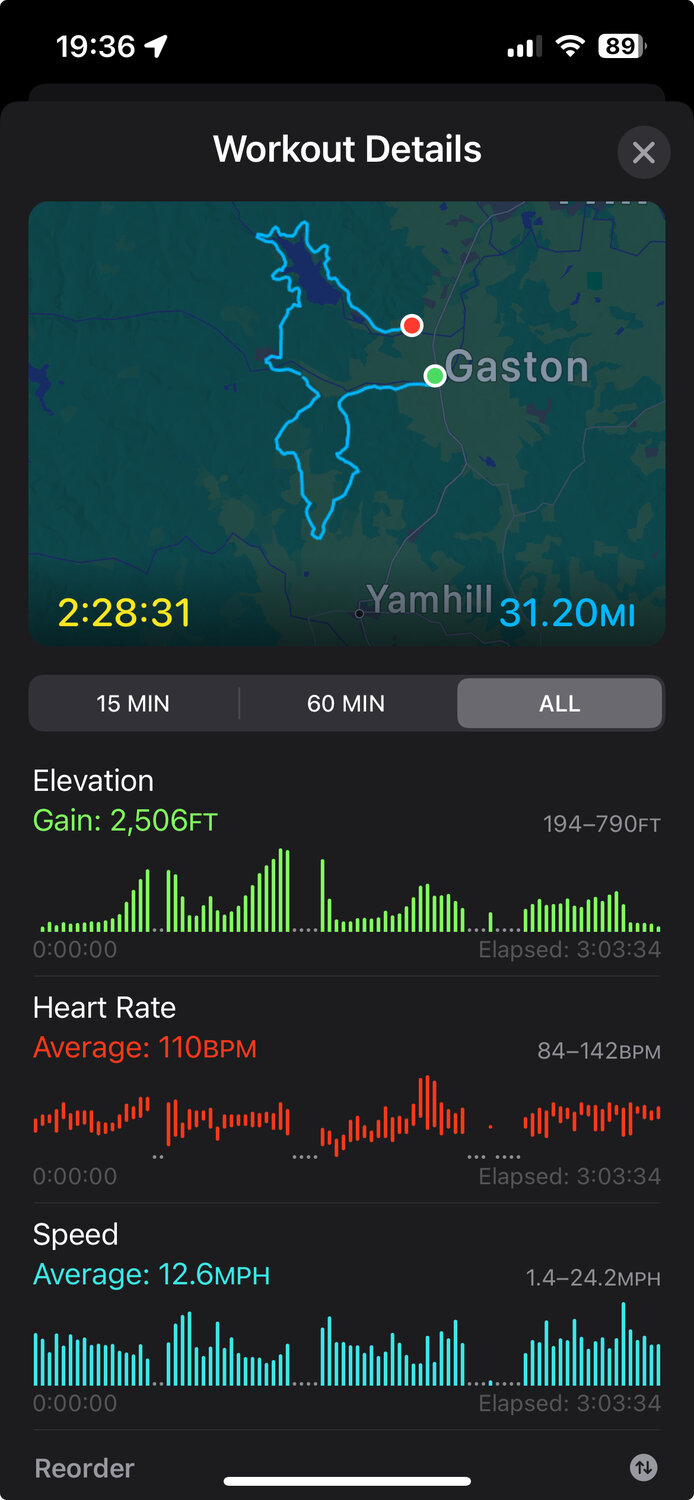

I used the the Apple watch workout application (attached is a screen shot). For some reason it stopped recording the last segment.

Hard to say much from this, no cadence, or motor input. take it back to the shop and see what they say…. Range has sooo many factors; I ride much faster 22-23mph average, and I may (depending on how much help I’m asking the bike) only get 32miles on a battery. 52miles is the best I’ve ever had using it rather sparingly…but again; lots of factors to consider.

I rode until the battery was dead. This was unintended since I assumed I can do at least 40 miles.

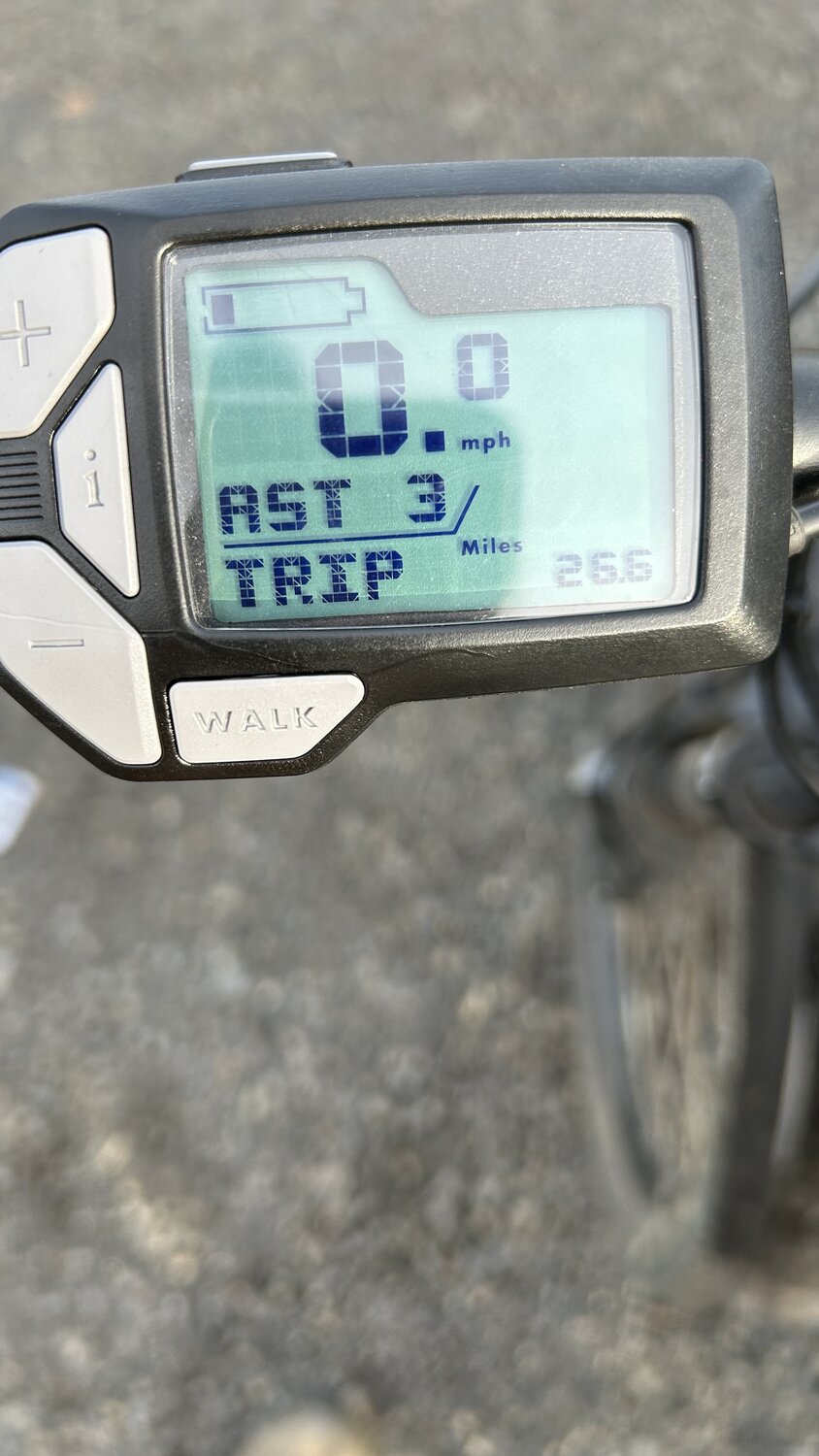

I tested this today on the same route I did yesterday and I was able to get about 25 miles as you may see in the attached files.
