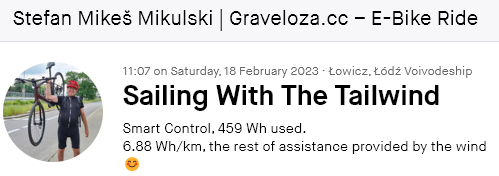

On any of the combinations as above I could connect Mission Control (by Bluetooth) and a Wahoo (by ANT+ LEV), and use Smart Control. An example:
In some scenario, I could see the Travel Mode (assist name) as SMART, and in other as TURBO for Smart Control on my Wahoo.
