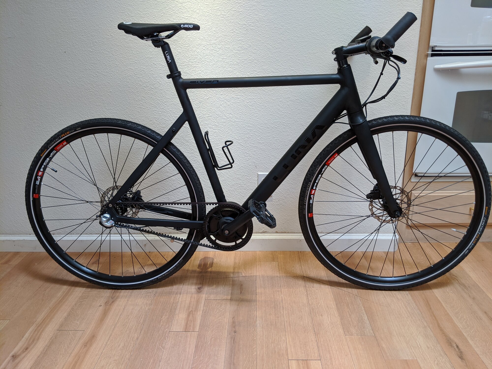

Not sure whether anyone brought it up: How do you remove the rear wheel on an IGH e-bike with a Gates drive belt?
I have lived that dream. It was what I call an RSB... a Royal Screaming Bitch. Fortunately I planned for it in advance and was able to do it. IGH was the little Shimano 3spd. The key to the process is derailing the Gates belt, which is most easily (!) done by deflecting the belt off the front chainring. First thing to do is screw in the dropout spacers that do the final tighten on the belt, but this is not enough to make the removal process easy by any means.
Taking pictures of the assembled rear axle on both sides so you can get the washer order right on reassembly is a big help.
The worst part is re-mounting the belt.
I loved that bike, and hated it at the same time. If I could afford to do another bike with a belt and a proper IGH (Kindernay, Rohloff) I'd go for it though. Once you have one its obviously a major leap forward in cycling hardware.
