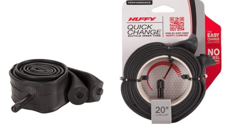

I've used this Quick Change inner tube before. One piece, slides around the rim. It really works and you don't have to remove the front or rear wheel. Huffy makes it in 27.5" an other sizes as well. Changed my wife's flat tire in no time at all without removing the rear hub wheel. Schrader valve only.
Huffy Quick Change Tube
