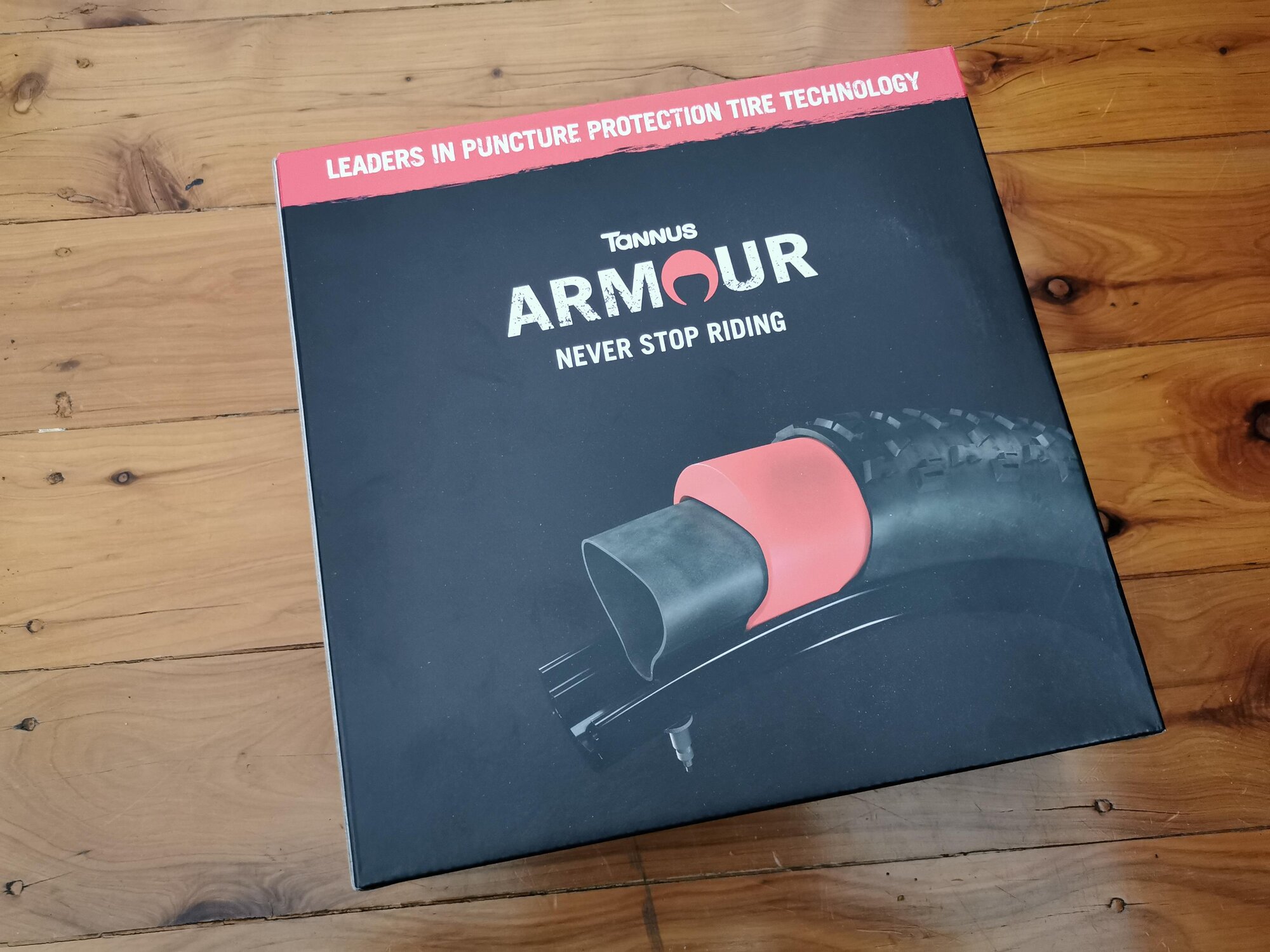

A set of these in conjunction with some high protection tyres may mean you never see a flat for the life of the tyres. I picked up a pair earlier today.

Interesting tech... what is the ride feel like with these tires on the road or off-road?
It's firm, unsurprising given they displace air with rubber. I don't find them unpleasant as I usually ride with my tubes up around 75 psi, but if you like it soft you'd compensate by running 10 or 20 psi lower than normal. The ride feels confident enough. My Marathons always required care in the wet or on slippery corners and I don't think the inserts will change that.
Install was easy enough, but took my butter fingers about an hour for both wheels. The Marathons are pretty rigid so didn't allow a long of room for flex. I used a liberal amount of baby powder on the inserts and tyre to ease everything back on the rim. Someone competent would probably do it in a third that time. I somehow managed to thread my front through axle Allen socket when putting everything back together (with a torque wrench no less)! So that'll be one for the shop to fix down the track.. 😭
The ultimate test will be how they fare with flats, so I'll check in if I have any issues in due course. Of course, now the axle lock is threaded I never remove the wheel again, so they'd better work!
I've come to really love the Tannus Armours. Hard to describe the difference. Definitely quieter on pavement.
From this review:
it’s really the foam insert and the density of that foam that dictates the ride quality. And I’d describe that ride quality as fairly muted. It’s a difficult thing to describe, so I’ll come at it from a couple different angles.
First: speed. Air compresses progressively, so a normal tire that’s only filled with air is easy to compress at first, but gets harder the more you try to compress it. The foam in the Armour insert is much more linear, so it feels fairly firm on small bumps at lower speeds. If you’re someone who’s extremely critical / particular about traction (especially at lower speeds), this is worth keeping in mind.
But as speeds pick up and you start running into things harder, the foam starts to feel more “right.” It feels like it’s absorbing impacts and rolling more smoothly through roots and rocks. Generally speaking, I’d say that mellower Trail-bike speeds were a bit too low, but the inserts felt better at higher bike-park speeds. There comes a point at very high speeds where it can feel a bit like the foam is getting overwhelmed on big bumps, but in large part, you can tune that out by increasing air pressure in the tube.
Cornering is somewhat similar in that there’s a certain speed, and a certain amount of force where the tire feels good. Speeds and forces above or below that can feel a bit less dialed — it’s harder to maintain traction compared to a normal tubeless setup with the right amount of pressure. That sweet spot is going to be a little different for everyone, but as with straight-line speeds, I was happiest with the tire’s cornering performance at the higher speeds I’d hit on lift-served, more DH-specific trails. Particularly at lower speeds, the issue is that the foam imparts some stiffness to the tire, so it doesn’t feel like the tire wraps around bumpy obstacles in a corner quite as well — it’s more inclined to skip off of mid-corner chunk rather than ease through it. I wouldn’t say the Armour is terrible in this regard, but it clearly gives up some traction compared to a perfectly dialed tire setup that has just the right tire pressure.
But on the topic of cornering, one nice thing about the Armour is that it provides more sidewall support. I found that I could get away with running fairly low pressures, even with tires that had thinner casings (e.g., Maxxis Exo). With the Armour, I could run an Exo-casing tire with ~23 psi in the tube, whereas with a normal tubeless setup I would (1) almost immediately pinch flat that tire with that setup, and (2) I’d roll the tire off the rim in the first corner. That’s also an area where the Armour distinguishes itself from a normal foam insert — I don’t find inserts like CushCore to do all that much for sidewall support, whereas the Armour definitely keeps even thin tires from getting squirrely in corners, which is fairly noticeable in bermed corners where it’s easy to generate a lot of sideways force.
From this review:
The Tannus inserts do an excellent job of reducing vibrations as promised, but that’s not all – Each time your wheel meets a big root or a sharp rock, the usual clunk is greatly softened by the armour. This extra cushion helps reduce arm and hand fatigue, as less technical sections become butter-smooth and big hits don’t rattle your bones like they usually do. In addition to protecting against pinch-flats, the inserts provide 13-15mm of puncture protection on top, and an extra 2mm in the sidewalls.
I was pleased that I didn’t feel any degree of rebound from the inserts. Where tubed wheels at higher pressures can feel bouncy in rough terrain, the Tannus-equipped wheels felt just as planted and pliable as a tubeless setup (even more so at lower pressures)....
As the testing went on, I let the tubes fall to lower pressures. As I dropped to 16, then 15, then 14psi, I felt the ride change quite a bit. I think every rider who tries out Tannus Armour will find their own sweet spot with tire pressures, as how low you go depends on where your priorities lie.
I’m not sure how much the Tannus Armour helps with rolling resistance, as they claim. I can see how supporting the tire from inside would theoretically help it roll, but even at 18psi I mostly just felt like my wheels had gained a bit of weight. Climbing traction was excellent with the lower pressure, but not drastically better than a tubeless setup.
As I dropped to 15 and then 14psi, it was apparent that the inserts weren’t making up for the loss of rolling resistance created by the super low pressure. Adding weight and lowering tire pressure isn’t the best recipe for uphill performance, and unsurprisingly the lower the tires got the slower they felt on the climbs.
When downhill riding, as the tires got lower in pressure the traction only improved. I never had any issues with side roll while cornering, which was a bit surprising as these inserts don’t flare out against the inside of a tire like Cush Cores do. I didn’t feel like they increased sidewall stiffness, but they definitely discourage side roll even at really low pressures.
Seems to me that the Tannus Armour is thick enough that pairing it with Marathons is rather uneccessary. Wouldn't a more supple and stickier tire be better?
Very possibly. Although I am really happy with the on road performance of the Marathons as is and do like their hard-wearing lifespan (mine are at 4000km and the tread looks like new).
I've also had a metal screw punch right through the thick lining of the Marathon. I had sealant in the tube at the time and it didn't seal the hole. It would have also gone through the Tannus if I paired it with a thinner tyre. Together I hope they present a formidable opponent to road debris.
My goal pairing the Tannus with the Marathon Plus is a) ideally and ambitiously never get a flat for the life of the tyre, or b) failing that, limp on to my destination without delay.
