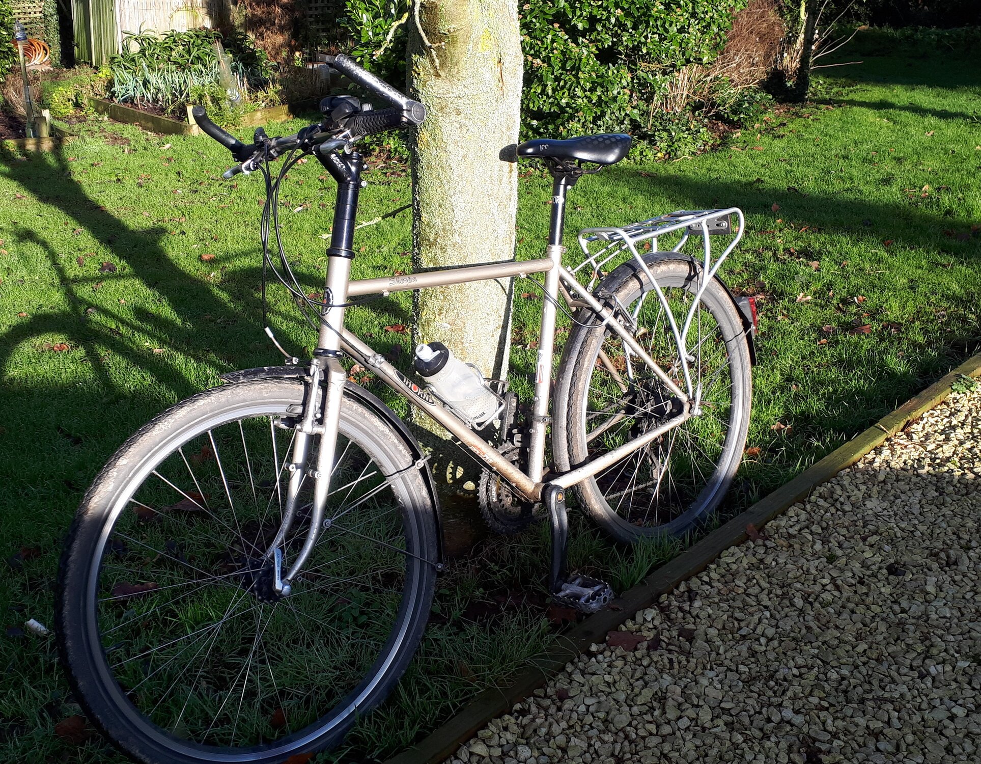

I also zoomed in on your Sherpa pic, and will be curious if you can fit the motor around those cable guides. I ran into that with a Cannondale Quick - unless I re-routed the brake and shifter lines, it was incompatible with the TSDZ2. A BBS02 fit right around it,, though...

Massive relief to find the cable guide and thus rear mech cable can stay in place. I offered the motor up today and luckily there is enough space for a free flowing cable no restrictions.
