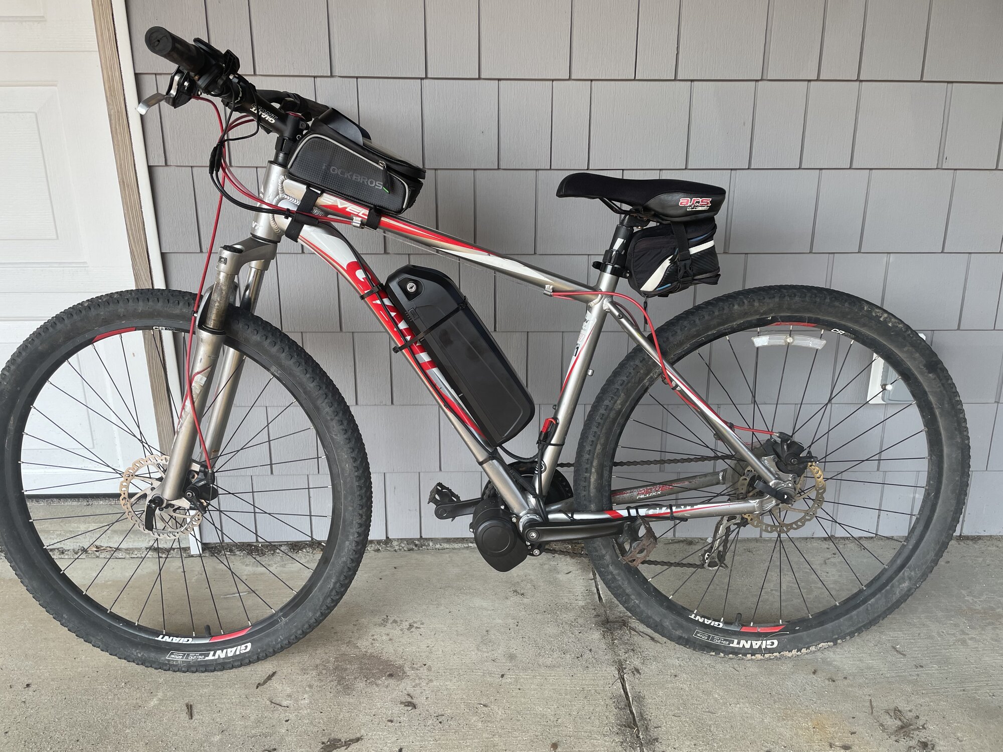

What bike did you install it on, pictures?

Installed on a Giant Revel 29er. I’ll post pics as soon as I can.
Now I remember you posting that. Great bike for your conversion.

Here is a pic. I am really enjoying this on trails.
