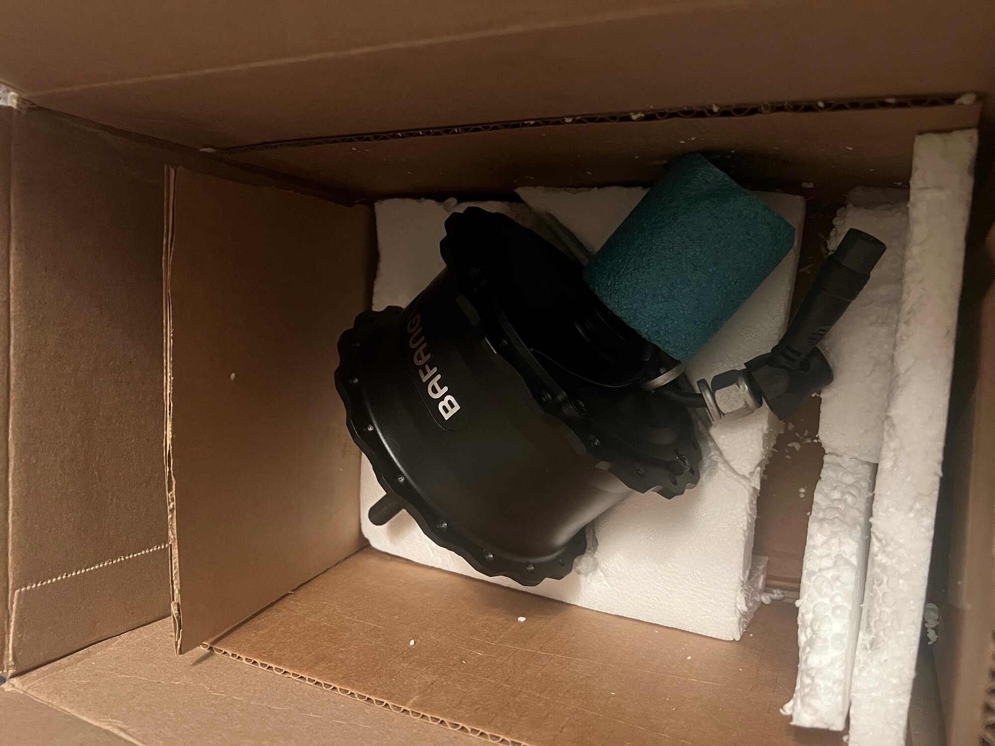

Since the warranty on my RadCity 5 is going to run out in a few months so I figured it's time for upgrades. The first part came in sooner than I expected because the website said back ordered. I was expecting a two month wait.
It's the "true 750 watt" Befang motor. I've seen a few videos showing how to install it on the RadRover 6 but not for the RadCity 5. I know I have to take it out of the casing but has anyone here upgraded the motor on their RadCity 5? The hub on the City looks a little different because it's not a fat bike so I hope there are no issues with the larger motor fitting.
Will there be any difference in power or noise with everything else stock?

Have you discussed this with the seller, the person you bought the motor from? You need a motor that's about 135mm wide. The fatties run from 170 to 190 or so.
I'm betting the 135's are available, and will install the way you want to. You just need to confirm the motor connector is what you need, and that 135mm width....

I haven’t talk to the seller because I bought it online from Electro bike world. I probably could call or email them but it was the only motor they had listed on their website for Rad bikes. If it doesn’t fit I’ll probably just keep my City stock because it doesn’t seem like there are any upgrade options for it. Maybe I’ll spend my upgrade energy on building an e-bike
